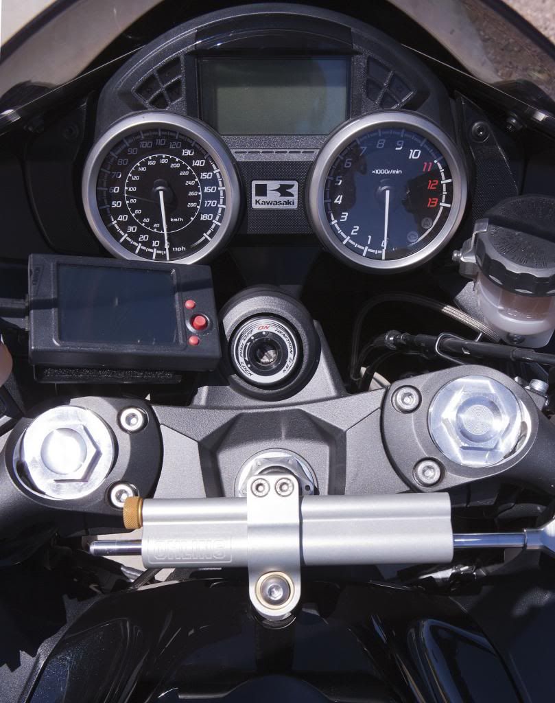

Land Speed 2012 ZX14R finished! Pics
Hey everyone..................
I finally finished my bike minus the metal battery box and holders, safety wires, and BMC race filter. I need to data log her at 4200 ft and about 90 degrees. We have some roads here in southern Arizona and over the border in NM that would be perfect except for the fact that it is totally ILLEGAL!!!! We'll see. Here are my mods and some photos.
[URL=http://s927.photobucket.com/user/azpaleo/media/5.jpg.html][/URL]
[URL=http://s927.photobucket.com/user/azpaleo/media/4.jpg.html][/URL]
[URL=http://s927.photobucket.com/user/azpaleo/media/3.jpg.html][/URL]
[URL=http://s927.photobucket.com/user/azpaleo/media/1.jpg.html][/URL]
Modifications:
Brock’s Performance Full titanium CT megaphone exhaust system
Brock’s ZX14R Clutch Mod kit
BST Carbon Fiber Wheels
Titanium Cush Drive Pins
World Wide Ceramic Wheel Bearings
Michelin Power One Race Spec tires “C” compound rear and Power Cup “B” compound front
Galfer Wave Rotors (front and rear)
Galfer sintered brake pads
Titanium rotor bolts (front and rear)
Titanium rear axle nut
Spiegler stainless brake and clutch lines
Dynojet Power Commander 5
Dynojet Wideband Commander
Dynojet LCD 200 for data logging on bike
Brock’s ECU reflash
Secondary throttle plates removed
Driven rear aluminum 41 tooth sprocket
Vortex steel front sprocket (stock tooth)
D.I.D. race chain
Titanium sprocket nuts
Lithium Battery
Trac Dynamics Slammerz EZ 2” front end internal lowering kit (gives me 1.5” of travel, keeping the tires connected to the ground at high speed unlike lowering straps or lowering in the forks!
Brocks Adjustable rear lowering links
****** Stock rake “bike attitude” was kept in-tact for optimum stability and traction, about .75” higher in rear vs front *************
Homemade aerodynamic mirror block off plates
Aerodynamic low profile windshield screws (believe me, parasitic drag matters at 200 mph!!!)
Internally mounted “true” flush-mount turn signals (euro style) with internal brackets (again, no drag and they work!!)
CRG 1.5” bar end mirrors that can be turned sideways to split the wind.
Tiger Racing land speed chain guard
Fender eliminator kit
Modified stock seat pan for lower sitting position under fairing and weight savings
Lowered aluminum kickstand
Dynojet Quick Shifter
Ohlin’s Steering Damper
BMC Race Air Filter
Redline 10W-40 Synthetic Race Oil
Evan Steel Performance Custom Tune along with custom data logging at speed…………………………………….
That’s about it, and she’s real real fast!!!!!!!!!

Gear it for 11,300 and for 3% slip . Mesure the tire with the psi ur gana use and use all the data on gearing commander.com
new14rider
Posts: 76
posted June 19, 2013 09:05 AM
What the hell is on the end of your hand grips??????
little bar end mirrors..... makes the bike street legal. rotate them 90 degrees for street racing (reduces drag) and rotate them back to ride normal. They work great and are easily removed.
new14rider
Posts: 76
posted June 19, 2013 09:09 AM
Sounds great! At Bonneville I will probably use 42 psi (you don't want a wide tire patch as on pavement). The salt needs to be cut through (not literally) with skinny tires..... less drag and less slip..... The higher the better. I have my shift light at 11,300.
Thanks!
