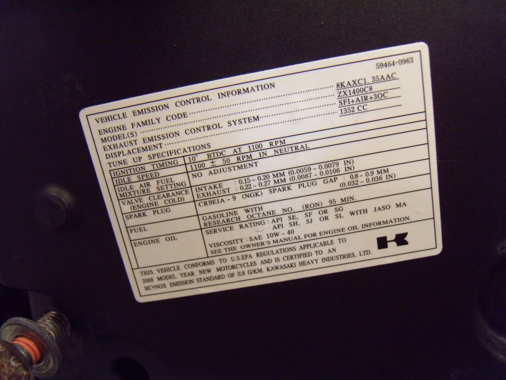

Yes I bought it new, its an 08. All stock inside. Only mod is r-77 slip on exhaust and gearing. Im 100% sure im hearing spark pinging. I know the valve lash wount cure this, but it needs to be done. Ill put this togather over the next few days with adjusted valve lash, new plugs, and a clean air filter and I plan on draining all fuel and fill it up with a known good fuel. Check out this picture from a lable on my bike frame. Does this not recomend 95 fuel??

Has it done this for more than one tank full of fuel?
Notice it says RON and not R+M/2. RON is research octane number which is always quite a bit higher than the MON or motor octane number.
The pump fuels in the USA have to be marked on the pump by the RON added to the MON and divided by 2 so you get the average. You have seen these yellow stickers on the pump.
So that RON 95 is like a 91 R+M/2 number.

Yes its been several tanks buy now, and thanks for clearing up the RON MON.
