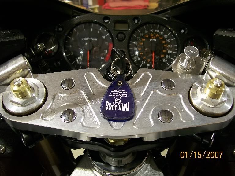

this is the one i got, i think it looks clean.IMO
it simply replaces the front brake bracket / no need to find a spot to install
