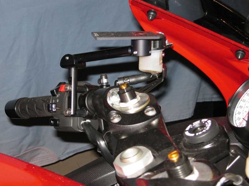

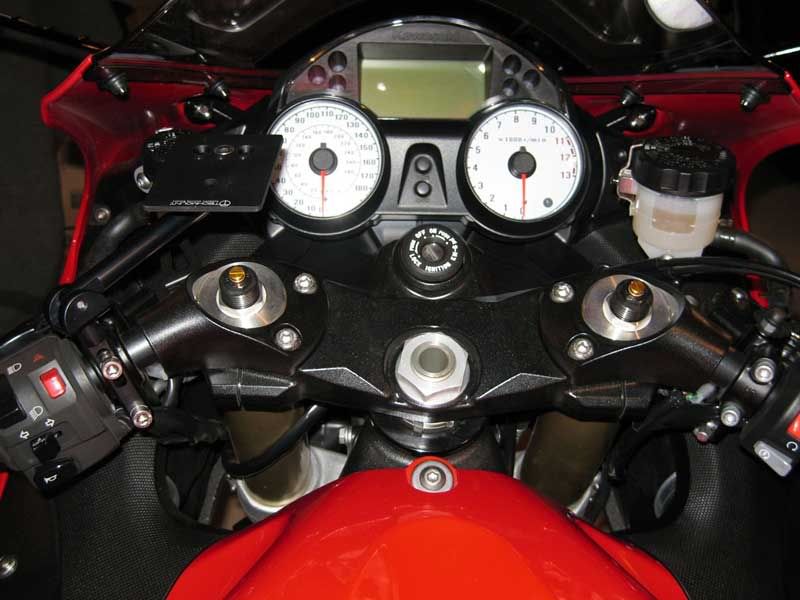

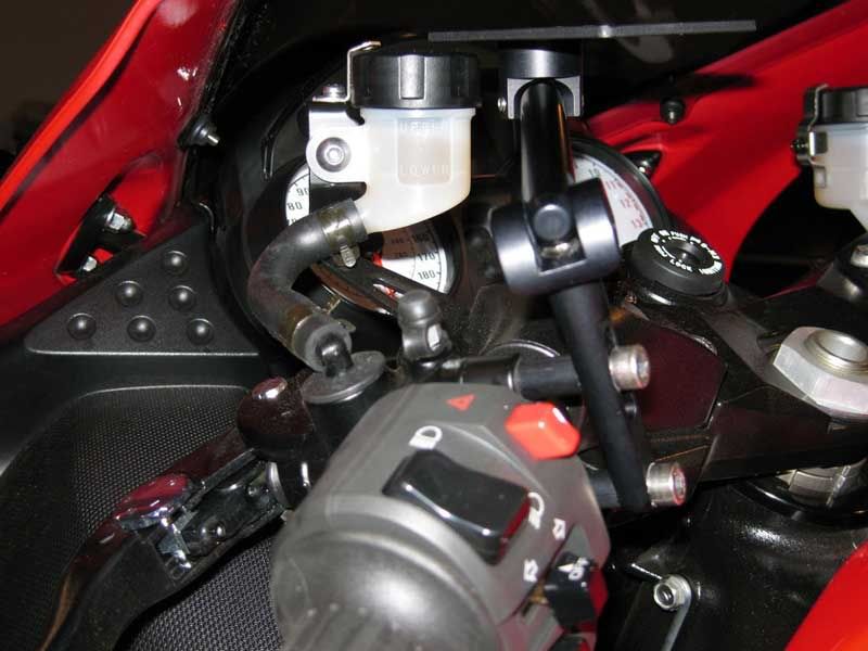

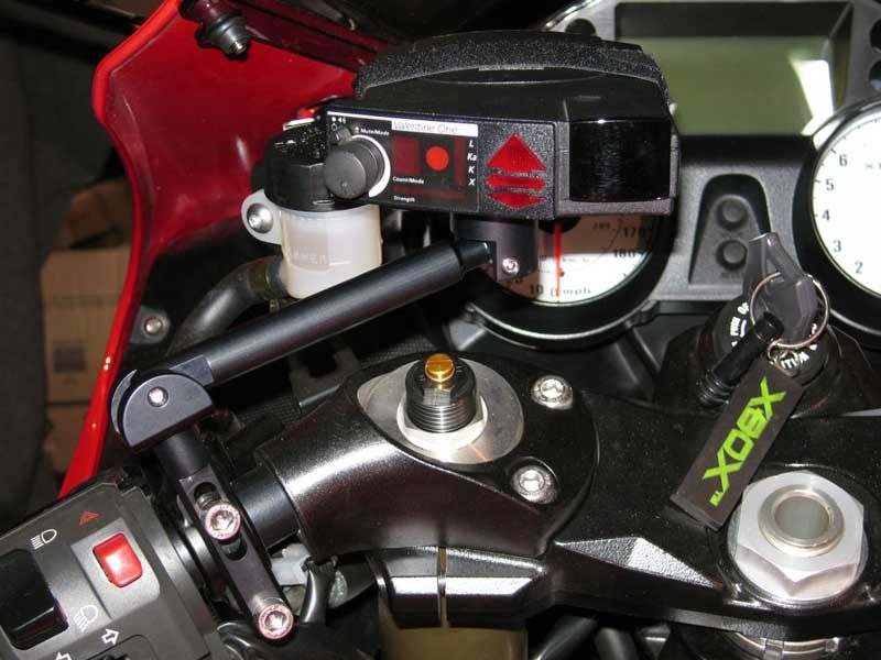

Radar Detector Mount - Techmounts/V1
I played around with the Techmounts control mount on the 14 last night. I like the solution, but it's going to take a little fine tuning. The location works pretty well - I think it gets the V1 up above the instruments sufficiently that it shouldn't hinder range too badley, and it only blocks less than 1/4 of the speedo (0-40mph).
I have sent Techmount a bunch of pictures, along with suggestions for a fork-tube mount like they have designed (but not yet released?) for the '06 ZX-10R. I think I'd like that setup better - you'd see less "stuff".

They have split mounts for this system, but it's hard to get everything down low enough so they won't block the speedo. If you had two items on this setup, you'd end up blocking the lower 1/2 of the speedo while you're in a sitting position. If you were in a moderate "tuck", I doubt you'd be able to see much of the speedo at all...
Unfortunately, there is simply no other place than control or stem to mount on our bike. I thought about something attached to the mirror brace, but unless it moves *with* the handlebars, it'll be in the way.

Because I didn't think it would reach that far over (out of the way) without a hell-of-a-long bar on it... too much distance. I want to be able to see as much of the gauges as possible, and get the radar HIGH so it won't be blocked by all of the electronics in the gauge cluster. I want an electronically unshielded view out the front if at all possible.
Sure, I could have used the stem mount like you did for the cam, but the radar would have to be so high up that I wouldn't be able to see the gauges. Not to mention having to "reach around" all that junk to get the key out...

I thought that too, but if you moved it out of the way of the bars, you wouldn't be able to see the gauges. This 14 is surprisingly tight under the faring. I've talked with Dee at Techmounts, they will have a prototype fork-tube clamp mount within a week or two that I'm going to try out. They made one for the new 10R and the fork tubes are the same external diameter.
