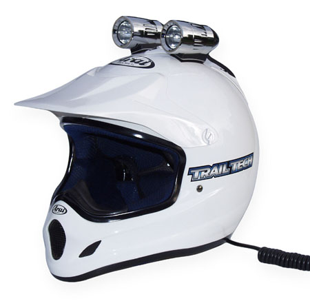

Here's how tiny those HID's are -- not that of course I'd be mounting them like this:

trenance, keep in mind the light pattern from those units probably won't be anywhere near what the stock lights put out. they tend to be a plain old round pattern like regular house lights, not the carefully shaped pattern vehicles use. that's not to say they wont work mind u. i use offroad lights with plain non-vehicle halogen bulbs. they work ok but certainly don't have the nice shape of the stockers.

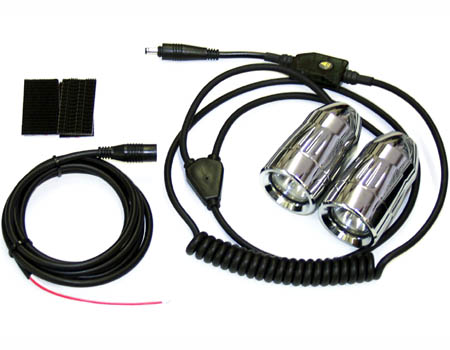

The photo supplied looks quite broad though as you say, with the right pic being the HID light, a single one I think:
It certainly doesn't seem patterned like the stock headlight but doesn't seem too bad?
Actually, doing the math, 12 degrees would be 15 feet wide at 70 feet, 30 feet wide at 140 feet, 60 feet wide at 280 feet, etc.
The above pic would have to be the 12 degree wide light I'd think.
While 6 degrees wouldn't spread to 30 feet wide (which seems to me would be a nice width) until 280 feet. It would still be reasonably concentrated light, only 60 feet wide, at 560 feet.
