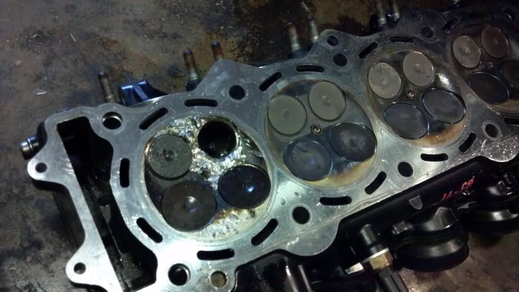

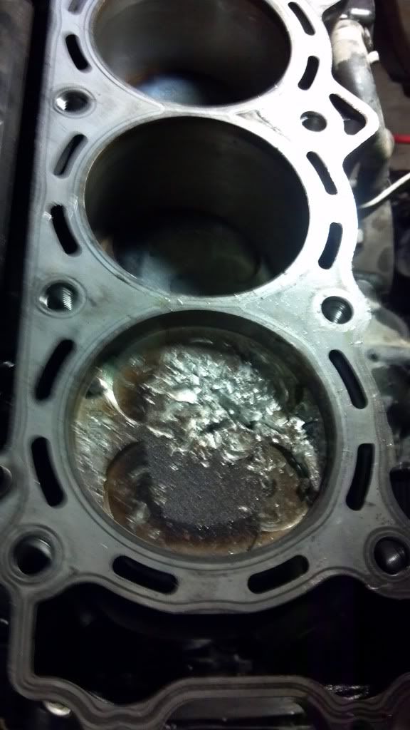

Happened a few weeks ago, by turning the crank bolt everything seems fine in the bottom end, just 3 or 4 small nicks in the cylinder wall. Head is probably unfixable.

I wonder if that much force could have.bent a rod or cracked something?

I think it would be cheaper and easier if I found a used motor and slapped it in a couple hours. Best case senario for this motor is replacing the head, boaring the cylinders, new pistons, rods.. a headache really, and more expensive.

Actuall,that head can be fixed.I had one worse than that repaired.Is the bore hurt?
KZScott
high on speed
Posts: 7235
posted November 05, 2011 06:30 PM
thats now a good candidate for oversized seats

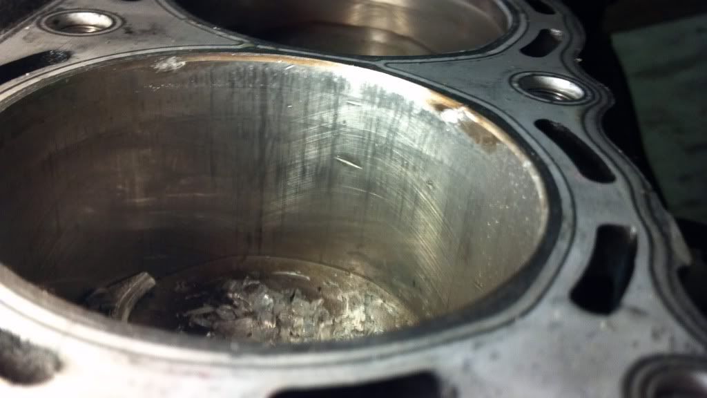

JZX
Posts: 943
posted November 05, 2011 06:58 PM        Edited By: JZX on 6 Nov 2011 03:22
You can see the cylider nicks and pretty bad at the top right of the pic.
above is a shot of the valve stem still in the head. What do you guess think, floated?
