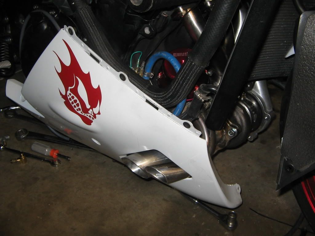

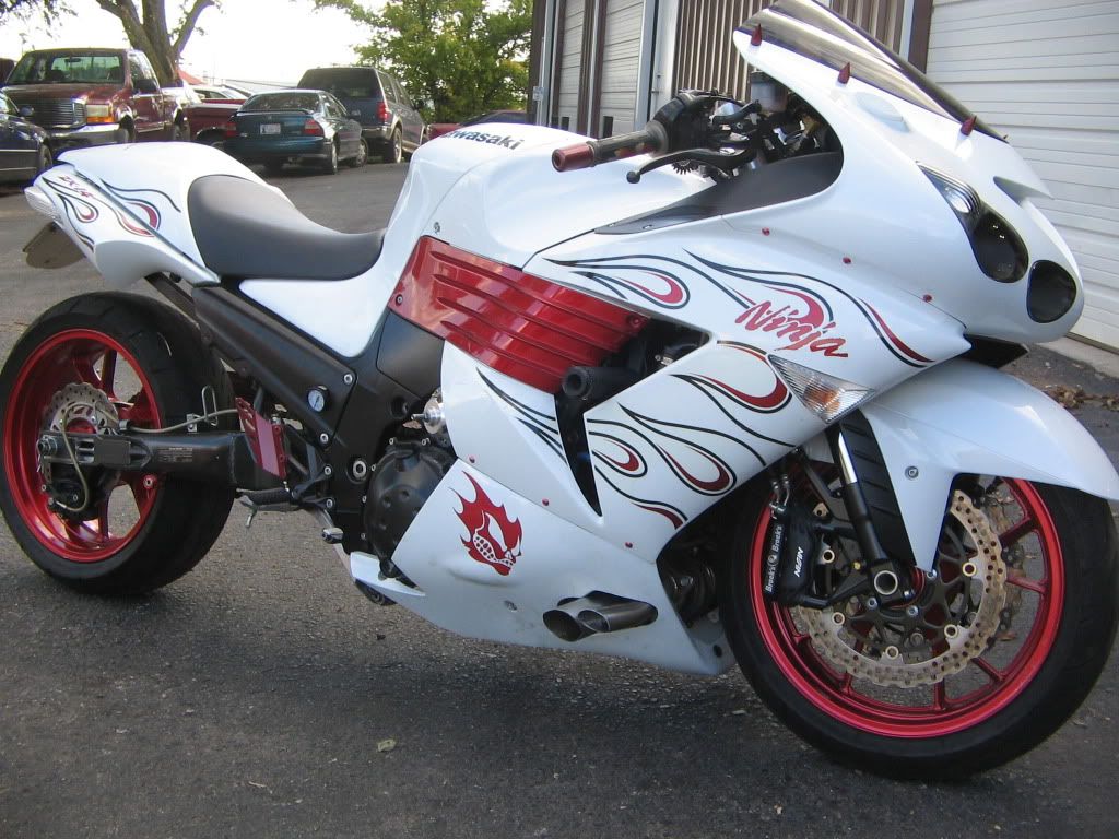

well after a little setback I finished it up.

Looks great, Big fan of the Pearl White myself!

clean install, Looks like a partial cycle logic kit.
detail?

your right ninja12, it is a cycle logic kit . we changed to an external waste gate and an walbro external pump. its a stock motor with low boost. of course this winter hes planning to build the motor for some higher boost.

Which Turbo is it?

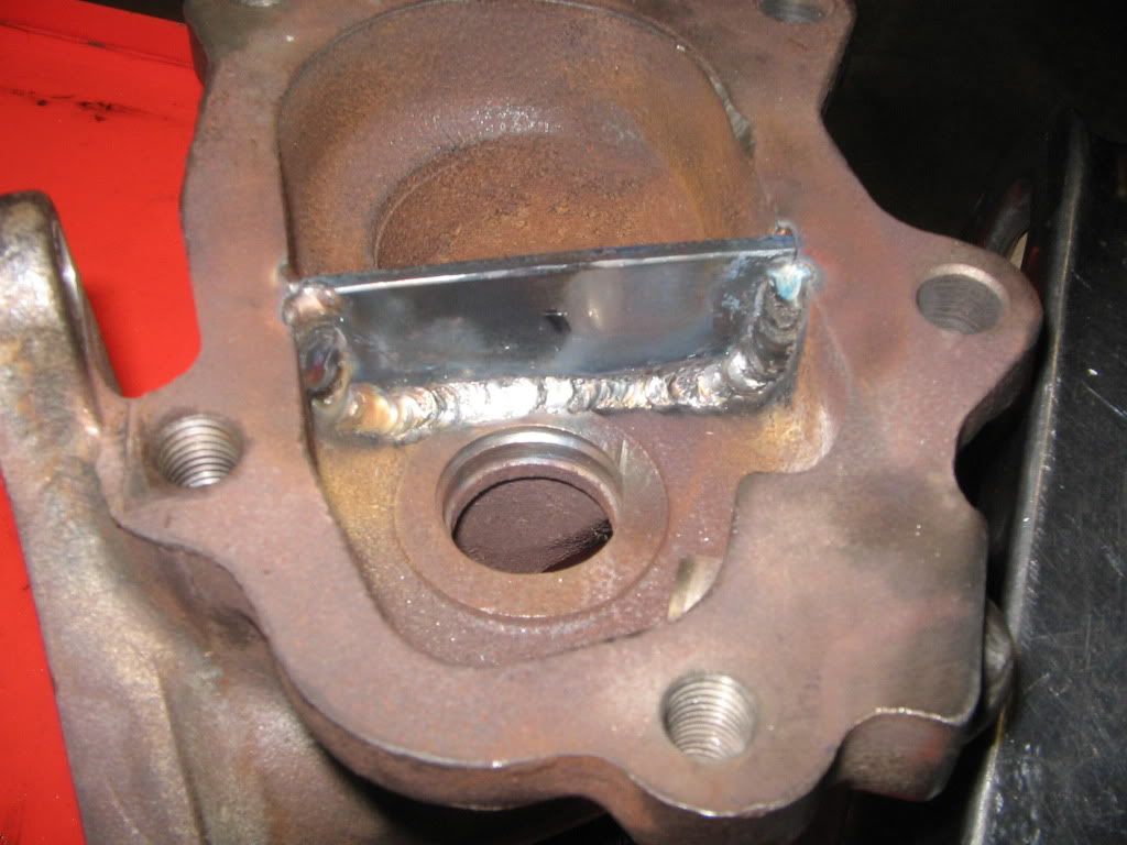

why didn't you just run the internal waste gate . and is there a reason for all the turbo cold air intake housing bolts being off even installed on the bike i can see no bolts .. . i can see its a cycle-logic set-up

external waste gates dont boost creep as bad as internals and its a lot easier to get the right spring for the boost you want versus an accuator. And if you are talking about the two bolt holes on the cold side of the turbo thats where the bracket for the internal waste gate used to bolt on.

heres a pic of the same setup with both kinds of waste gates

Thanks for the pics, I'll use those when building my kit.
