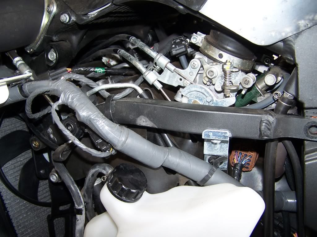

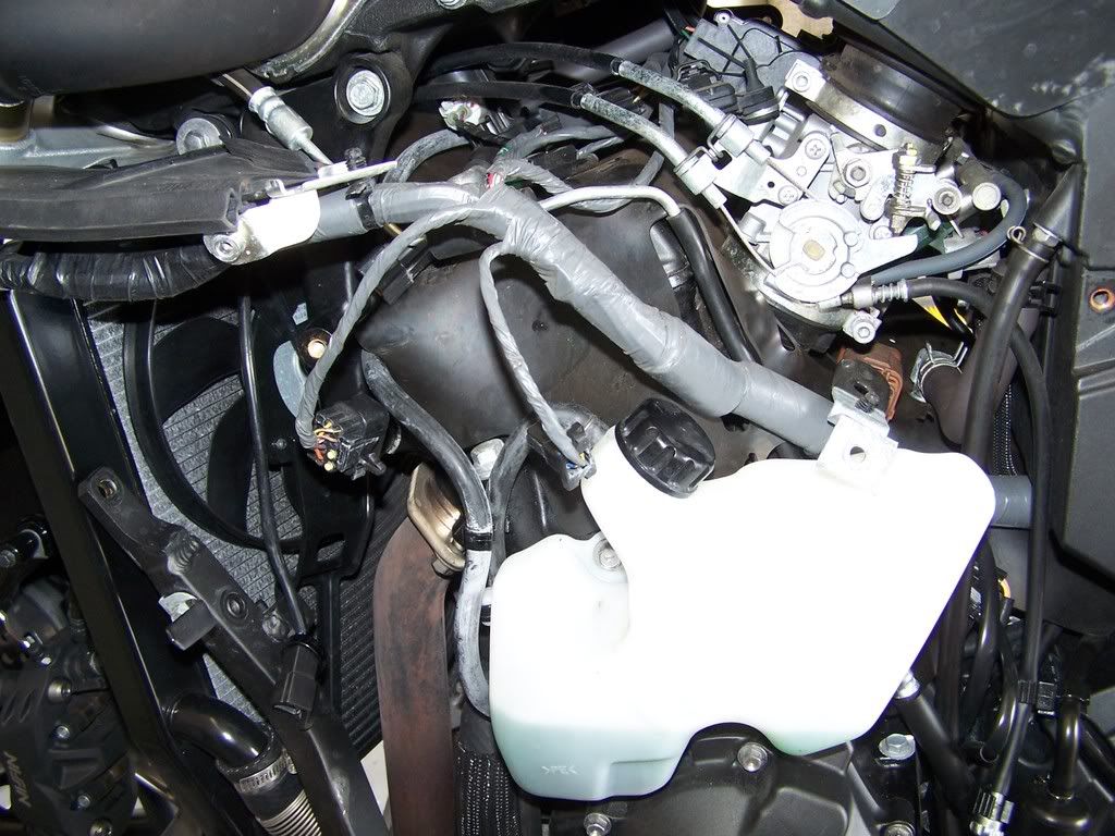

please tell me what is going on with this oil
i started tearing down my bike today and i found oil on the left side of the motor. top of motor is dry but its all on the side. did this come from the air box or what do u guys think?PhotobucketPhotobucketPhotobucket

I'm thinking valve cover gasket.

Could be the airbox, there is an drain/catch and tube running down that side of the motor. I've never gotten any oil out of mine but I have heard of others finding some in it. I also heard overfilling the engine with oil can cause it to accumulate there too.

That def looks like the valve cover gasket

Chances are you're overfilling with oil. You should only be in the middle of the sight glass. Any more then that and oil will accumulate in the airbox and spit out all over the front of the engine case.

Thats for sure the valve cover gasket. I caught mine early and fixed it , I guess, for now, Gasket, sealant....We will see

Looks just like my 08 did. It was the cam cover/ valve cover gasket. I orderd the updated gasket, but it was the same one that came on my bike out of the factory and I did not want to replace a bad gasket with a bad gasket. So I just put thin washers under all 6 bolts and tourqed to spec without removing the cover and cleaned the oil off the motor. It has been about 1000 miles now and lots of heat up cycles with not the slightest sign of leaking. Took me about 1:30 from start to finish. It looks cramped in there but you can get the cam cover bolts off and back on. You will need a low profile or small torque wrench to get to one of them (I think it was the front middle one). Use M10 washers. Photobucket
