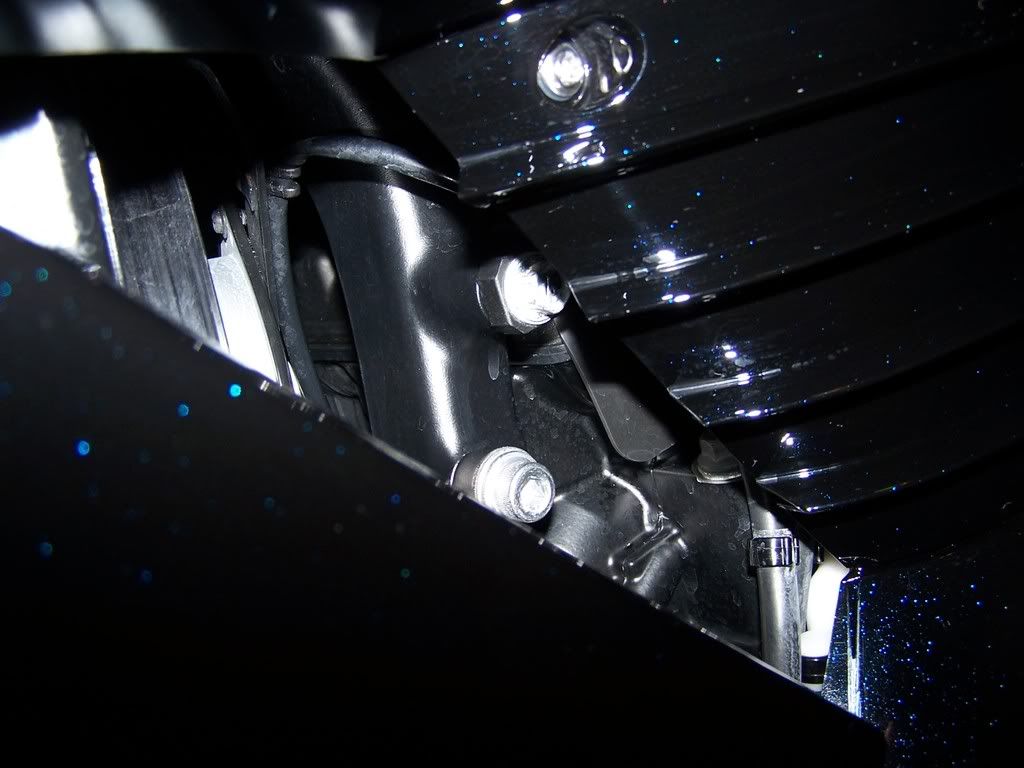

Success! I can say that just putting washers on without replacing the gaskit will fix this problem! Thats great because it saves anyone from having to remove the cover which would take much longer.
Photobucket
This was after 6 hours off sitting on the kickstand and several heat cycles. No sign of leaking Photobucketaking.
Sparkle sparkle..Photobucket
