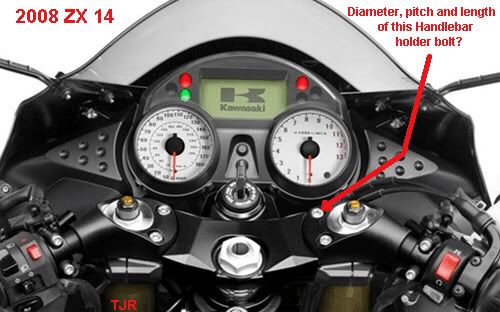

Could someone tell me the diameter, pitch and length of the OE bolt on a 2008 14 in the below pic?
If you happen to know the depth of deepest part of the holder recess at the same area it would be helpful as well.
TIA,
Todd

The original stock bolts are: 8mm x 30mm x 1.25
The hole in the top triple clamp is open, not a blind hole.
If you are using GenMar risers you need bolts that are: 8mm X 50mm x 1.25.
These measurements are for my 06 ZX14. I'm assuming that the 08 is the same.

Thanks, 8mm -1.25 x 30mm is just what I was looking for. Not concerned with triple clamp bore, just the depth of the h-bar holder recess... staying bone stock with all and just adding a bracket above clamp but need to fab before I have hands on bike.
Thanks again,
Todd
