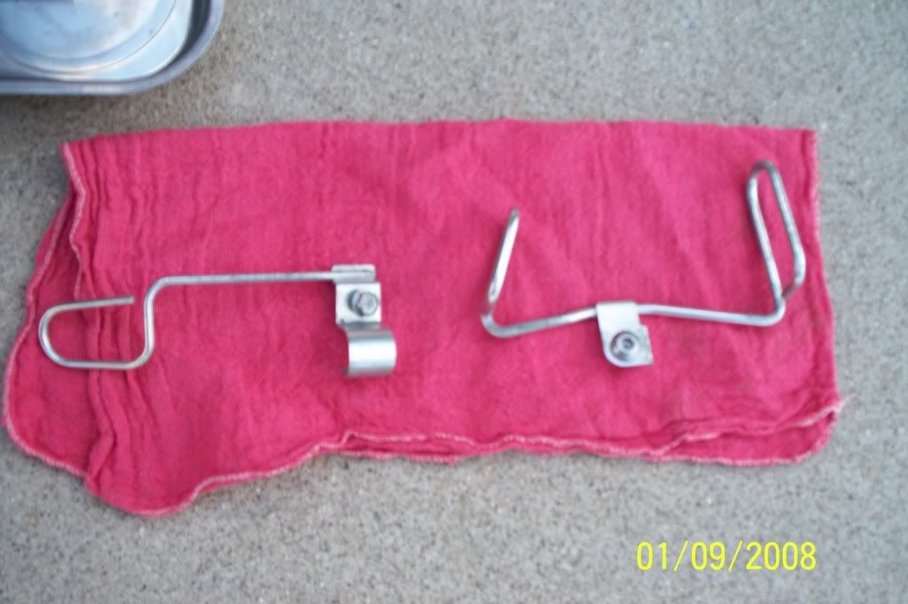

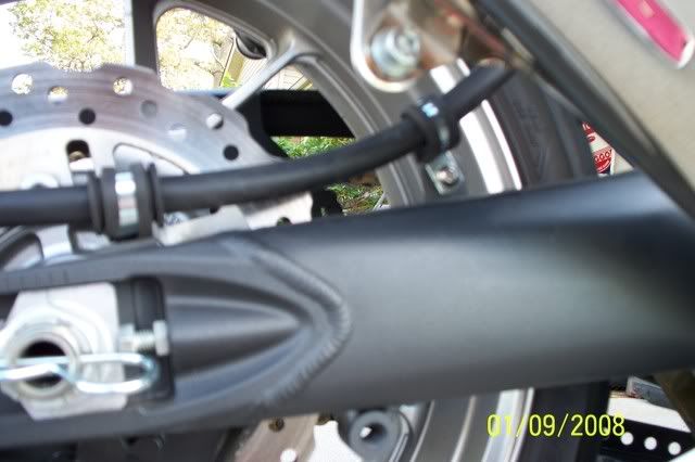

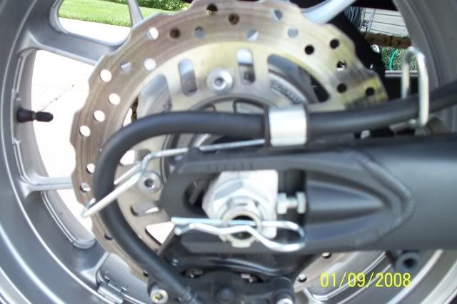

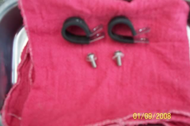

I hated the stock bent wire brackets for the rear brake line. Not only did they look like crap they are already corroded and make cleaning the swingarm at pain. So I went to the the local hardware store and got some stainless strap clamps with rubber insulation and replaced the stock stuff in about 15 minutes.

Did the hardware store have those screws also?

Hose Clamps...
