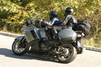

Turns out it's a good thing we were both wearing full leathers when we had this photo taken! We all knew something was up with the numerous reports in our forums at www.Concours14.com of Saddlebags falling off new Connie's. It appears as though Kawasaki is stepping up to the plate and doing something about it. Documents filed January 23rd of this year with the NHTSA detail the recall, and were forwarded to us by one of our members who's a C14 owner.
