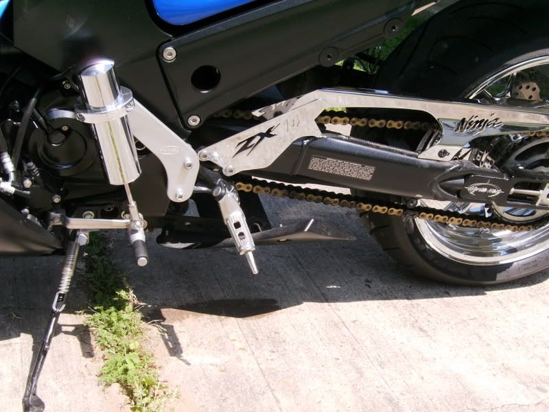

How do you guys with air shifters have your rams mounted?
Is there a way without spending $90 on a Muzzys mount?

tap the motormount with a stud. wee

Kinda thought that the motor mount bolt looked like it could be threaded inside.
Have you had any problems with the clevis binding on the shifter arm?

replaced it with a longer one. wee

do you remember what size you tapped into the mount with???

tap was a 5/16, I dont remember the drill size. then used a carburetor stud, fine thread bolt 2 1/2" long. you need a spacer and some washers to get the shifter tight but it has some movement at the top. wee

Use a 17/64" drill bit to bore out the motor mount bolt, use a 5/16" tap and use a full thread 5/16" bolt and a spacer.

Thanks for the info & the pic!

I used a threded rod and put it through the engine mount hole, made a spacer and bolted everything up. Works great.

Yep, seen that done as well, you will need to use 1/4" to do it that way. It is probably the easiest to do.

I used a nut that we use at my job,its for a bolt on valve cover for a aircooled VW engine. I thread one end to fit the zx engine stud 10mm X1.0 (if I remember correctly)and the other end is 8mm X1.25 for the ram bolt.Ill try to find a pic.
