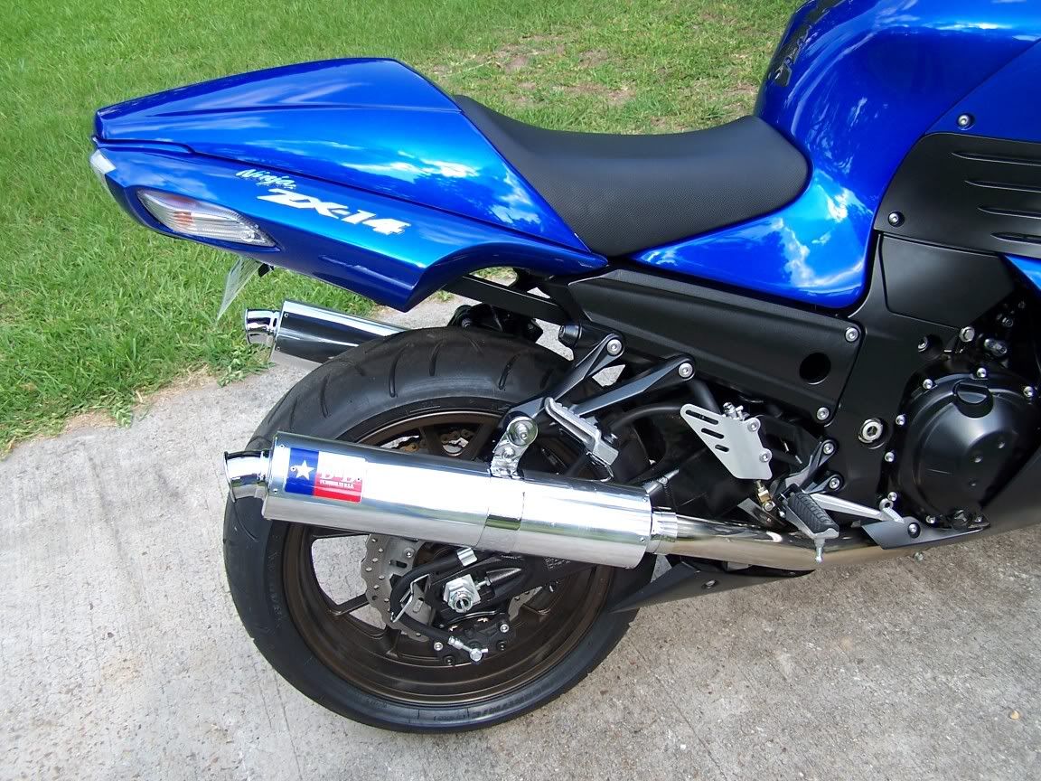

I went with slip ons for two reasons. First I like the two can look, and second I had a set of polished D&Ds in the shop that originally came from a Busa, I had adapted them to my ZZR1200, and when I traded it I kept them, so the change was very cost effective, like free. I just band sawed off the stock cans and kept the stock headers and mid pipes. Added advantage was the loss of weight, and the lack of restriction plus a killer sound. Since then I pulled the flies and added a PC using zx1krs no flies map. I would definately go with the PC no matter what system you decide on. I am waiting to custom map mine untill the timing module comes out, but am loving it the way it is.....TB
