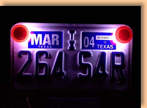

Um---Matt is there not some sort of requirement to have a light shine on the plate??
  Ignore this member    Click here to send EASY an AIM message.
zerMATT
Posts: 1931
posted May 08, 2006 05:09 AM        Edited By: zerMATT on 8 May 2006 06:32
Yes, yes there is But only if you ride at night. (which I do occasionally)
I have two of these thingys on order:
Also, you can check out the other thread that's covered this topic pretty well:
http://www.bikeland.org/board/viewthread.php?FID=27&TID=23433&set_time=
