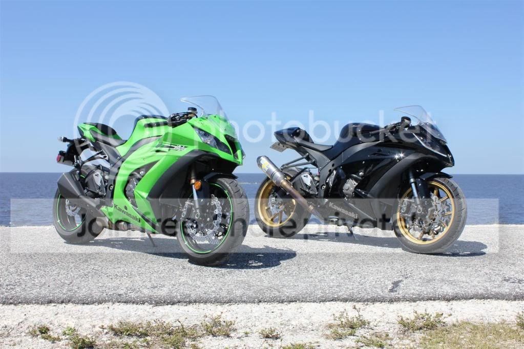

Hey guys, had such a long day but thanks to forum member "kryologik" bringing up his bone stock ZX-10r we put her on the dyno and did some pull's.
First pull you can see in the dyno graph the secondary's restricting all the power. Max power at 13,300rpm's was 152hp which on a dynojet would be 164hp. With the flashed ECU from GUHL MOTORS Max power at 13,300rpm's was 167hp or 180hp on a dynojet dyno.
There is a 8% difference between this kind of "sweep" run on the factory pro dyno compared to a dynojet number..... now these "numbers" are simply that, just numbers so don't get disappointed in them if they sound low. Look at this as a before and after comparison!
I also did this on my bike as well to see what the timing differences would be and having a flashed ECU from Guhl motors as well as the secondary's removed I gained 4hp from having a flashed ECU from Guhl to put the timing back into the bike.
WELL WORTH IT to have the ECU sent off to be flashed to remove all the restrictions and put the timing back into the bike, a very good way to get those extra ponies out of the bike.
