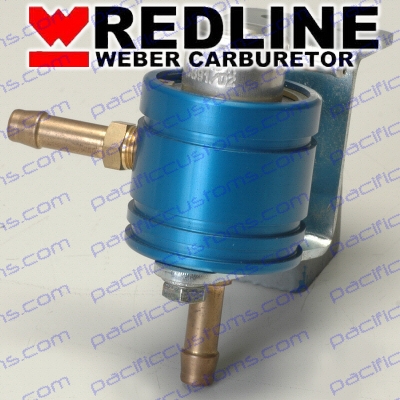

I use one of these: http://www.pacificcustoms.com/mm5/merchant.mvc?Screen=PROD&Store_Code=PC&Product_Code=RLWFR-525&Category_Code=
The regulator is fixed pressure, but it's replaceable. Replacement units ranging from 3.0 bar to 5.0 bar can be installed in the billet housing.

That means that there is a port that can be tied into vacuum or boost to vary the regulated pressure. That port can be left open to atmosphere if variable pressure is not required.
