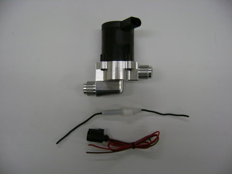

Hey guys, going with a dry sump I lose my mechanical water pump. there are some fancy electric pumps out there like the RCC pump
$375
Muzzy has a pump also
$210
Motor: 12V brushless
Operating voltage: 9V to 15V DC
Max. current draw: 1.3 Amps
Pump type: Recirculating* Centrifugal
Drive: Magnetic - no seals
Operating temperatures: -10¾F to +250¾F
Burst Pressure: 36 PSI
Flow Rate: 4 gal./min. @ 10 KPa
Weight: .54 lbs.

would this work out for a replacement water pump for the bike? the flow rate seems high enough to me?

I think the Bosch intercooler pump (I have one on my bike for the intercooler) moves less water at less pressure than a pump intended to replace the mechanical water pump. I think mine runs at 2-3psi.

I use a Craig Davies Electric Water Pump on my dry sumped 1270. It moves 80 liter/min (about 17 gpm) so it's a lot more than the Bosch and others you have shown. I know several others that use this pump and it seems to work well replacing the original water pump. Its about $260.

ok ill knock the bosch off the list
is it just me or is this the "muzzy" pump?
http://www.daviescraig.com.au/Electric_Water_Pumps-ELECTRIC_BOOSTER_PUMP_12V_SHORT___PART_No__9002-details.aspx
The EBP is a ‘brushless’ 12 volt, high flow, magnetically driven water pump. The EBP motor has no brushes to ever wear out and the pump is magnetically driven by the motor, which means that no shaft sealing is required.
The many EBP applications include: booster for car heater and LPG systems, solar pump applications, water cooled motorcycle, go-kart engines, turbo air / water intercoolers & household irrigation.
$132.00

I ordered a Muzzy pump
EBP are out of Australia
