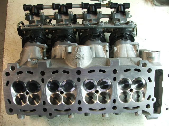

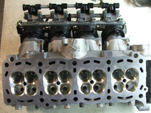

The new zx10 should give our new stage 3 gsxr1000 grudge head a run for its money. its all ready got the big buckets and big valves.
Here's a sneak peak Bikeland Dragbike Zone exclusive !!! You wont see this head or setup anywhere else until mid March. No doubt this setup will be copied very quickly by the others.
We are testing this week and we are expecting big power from it. It uses aluminum spigots and 46-49mm throttle bodies and has huge valves and a special chamber design to promote tumble. We use a new 3D laser scanner and Mastercam X3 to design and replicate the chamber.
Here's some pics......

Which cylinder head is the above pictured ? 2011 ZX-10 or GSXR1000 Grudge cylinder head ?

The 18G cast into the thermostat boss indicates that it's a GSX-R1000, 2003 or newer.

Dang! Not a lot of room for valve expansion due to heat.

Pete, there not really that close together. Thats not an issue.
