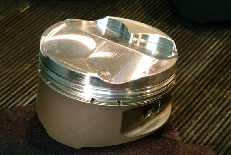

new style JE pistons
from the top no real difference, except new ones don't have a detonation hole
from the side, looking pretty similar, except a bit narrower skirt
underneath, big differences, bracing + thicker skirts + narrower pin bosses + dimple under int side Quench
measured em up tonight, all 3.4231 +/-.00005
you have to ask for new "Busa" style.
Better? 6 gm heavier. Significant? who knows.
I like the thicker skirt.

BTW: right after taking tose pix, i cut down the sharp spots;

Do you still anticipate having a spark plug clearance issue? I notice that you spent some time processing the center of the piston crown. Or were you just trying to make up for some of those extra 6g?

The #1 thing I noticed were the Ribs! Second the Skirt looks longer but narrower, Third is the Depression under the Bottom RIng Land

i took down under the plug a bit for safety, although there is enough clearance for the Denso's. Like you say, also helps the weight a lil bit.
Stuart,
yep, that piston had a rough day, but before it went to sleep, it propelled Doug Meyer to new US record for NA Kawasaki 208.793mph, and even got my TFA to 208.740.
Vincent,
you are correcto except for the skirt length, they are the same, both cut down from "normal" JE's for 12's.
Also pin boss is narrower, and its thicker around the rings.
all in all, it's generally more robust.

Looks like a very tough piston! I would have chamfered the edges of the valve pockets a bit more, but Ive been building for nitrous, and a little extra rounding at the cost of compression is no issue. my .02(cad )

I would go a little further and take the edge off the valve pockets. No sharp edges.
Next, I would tape up the piston ring lands and lightly bead blast the top. This gives a teflon like look to the top of the piston. Allowing carbon to build up a nice even layer and help insulate the piston from combustion temps.
All this with a good map running 12.7/8-1 A/F allows me to run 14:1 on 91 pump!

Here's an example of what I do to those pocket edges. This is a ZX-11 piston for a little project I'm working on.

Not likin the valve pockets near the edge of the piston much. Notice the old ones chunked off...
I too radius all the sharp edges off my pistons.
I cut those things right down, and honestly do not understand why the manufactures don't cut them right off when they are only 1-2 mm wide and 2-4 mm deep... looks like and opportunity to take out my turbo...
... all they would have to do is make the valve releifs 2mm larger ....

If they made them larger on the diameter you'd increase chamber volume (lose compresh). By doing it the way they do, they give you the max and let you decide on the reliability/power tradeoff.

I have to be careful about how far i trim down the "sharp spot", the deepest aprt on the int pockets are only .020 from cutting into the ring land.
BTW: right after taking the comparison pix, i cut down the sharp spots (posted above)
