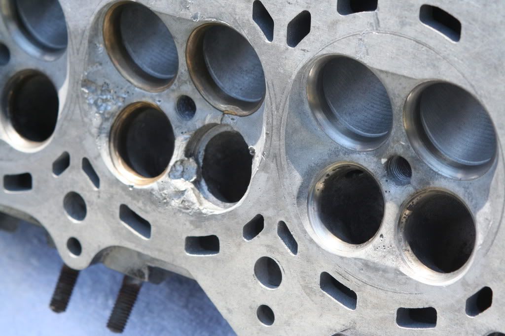

owch!
cyl #4 looks like it has been repaired between the exh seats??

wondering if its worth fixing. i got $3500 in that peace of junk. never noticed # 4. but it kind of looks like that.

$3500 headjob...
I know the feeling. I am also playing head game.

That can be fixed no problem. It will need some welding, 4 seats, valve job, resurface.
How are the guides? I cant see from the pics but it may need a few guides also.
It does look like it was welded on #4 in the past. Did you have it repaired once before?

it's going to need a few guides. never had any work done on #4. that i was aware of...scratching head.lol

Did you buy this head new? It could have been done before you owned it.?????

must have been. how much do you think it well be to get it back to the point that i can put valves back in? just # 3. pm me if you would. thanks.

I have one that looks like that. Thinking of holding on to it, and having it repaired, and built.........
Its stock and damaged right now.........

A damaged head is a good canadate to do bronze seats and guides in. It need some new ones anyway.

it started off looking good.. from the cam side
damn bro. that sucks.
