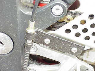

do you have pics of the bracket you made to hold cable?

there are a couple pix of my bike on Dale's site in the testimonials section, green 12. it shows the bracket

Pic is too far for me to see it correctly.. i like it better than the one above...

The bracket is a big door hinge i got at Home Depot. The pins of the hinge just pappen to fit the cable receiver hardware perfectly. All you gotta do is drop the peg mount and bend the hinge, drill a couple holes to mount behind the peg mounting bolts, then cut off the parts you don't need. I like it because you don't see the bracket al all.

same pic as above just a little larger...
will post if ya like?

well put it in yesterday.. but have not fine tuned it yet... just wired it up ...
BRACKET ALA KARL'S SUGGESTION
