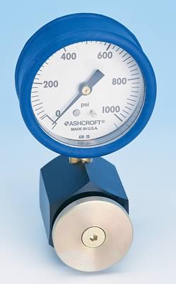

I agree with Cowboy, you need a spring tester. I was thinking about getting this one. It's the least expensive and most portable one that I've found so far. You just sandwich this thing in a vice with your spring.
Anyone here have any other opinions on which spring tester to get?

that's a pretty coll lil tool. got a line on who sells em???

I actually found the above tool at summitracing.com

That is the best one for this application.imo

THAT tester (in the picture) goes WAY TOO HIGH to do any good for clutch springs...
Didn't look at the Schnitz tester but I'm sure it's range is lower???

Kev, thanks for the confirmation. I just threw up the pic. I think the right one is 100 psi max. Right?
