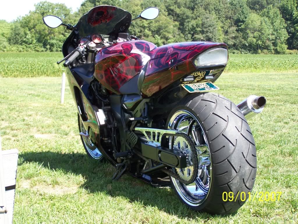

If ur rear aint as wide as mine, then i aint racing you, you not gettin a win that easy!!! LOL!

That looks really nice.,..300? I think the tire is going to grab that license plate though!!

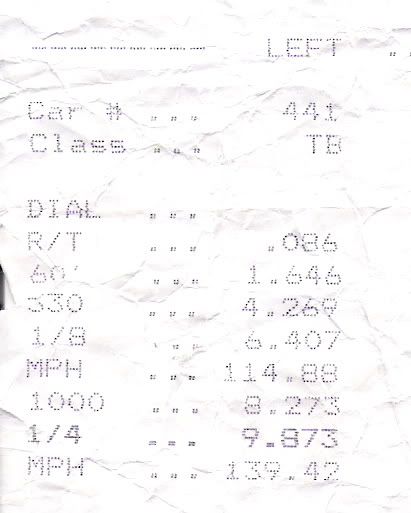

Sorry for the boring posts, i'm down for 3 to 4 more weeks after this back surgery, n yes........I am hella bored, the 12 side seems so dead now that the 14 came thru which is understandable, n facebook almost got me into trouble wit by babymomma, lol! I just put a 49 on the back which now is geared like going -1 front, n +2 n the back, so as soon as i get my act together i will go to the track n see what it does, so far after 4 trips n 11 passes i've went from 10.37 to 9.87, mayb i can see some 9.6x

Shane, its a 240 tire, i wouldve done a 300 but back the(4yrs) they only wider tire kits u had to go thru a jackshaft (2 chains) n that setup looked more like a pain in the u know what to maintain. The total weight is 760 wit me on it. It didnt help me going to the track once a month either, lol, I got faster by watching my shift points, at first i didnt even look (nerves) n then i was shifting at 10500 or so, n after some advice on here i started to shift just after 11k. The air ride kinda makes me wheelie to easy out the hole, its like pushing down on a basketball, u know how it pushes back after u push it, lol, Actually the bike is bottom out in the pic, i raise it up wit the air ride when i ride it, i can put a big girl on the back n it never hit the plate, lol
oh, n we all know u like BIG sprockets!!!!!!!!!!!

You can (should) shift it at near 12k indicated. The stock tach reads about 500 rpm over actual and the bike won't hit the limiter until about 11600 actual!
Good ET based on what you are telling me!

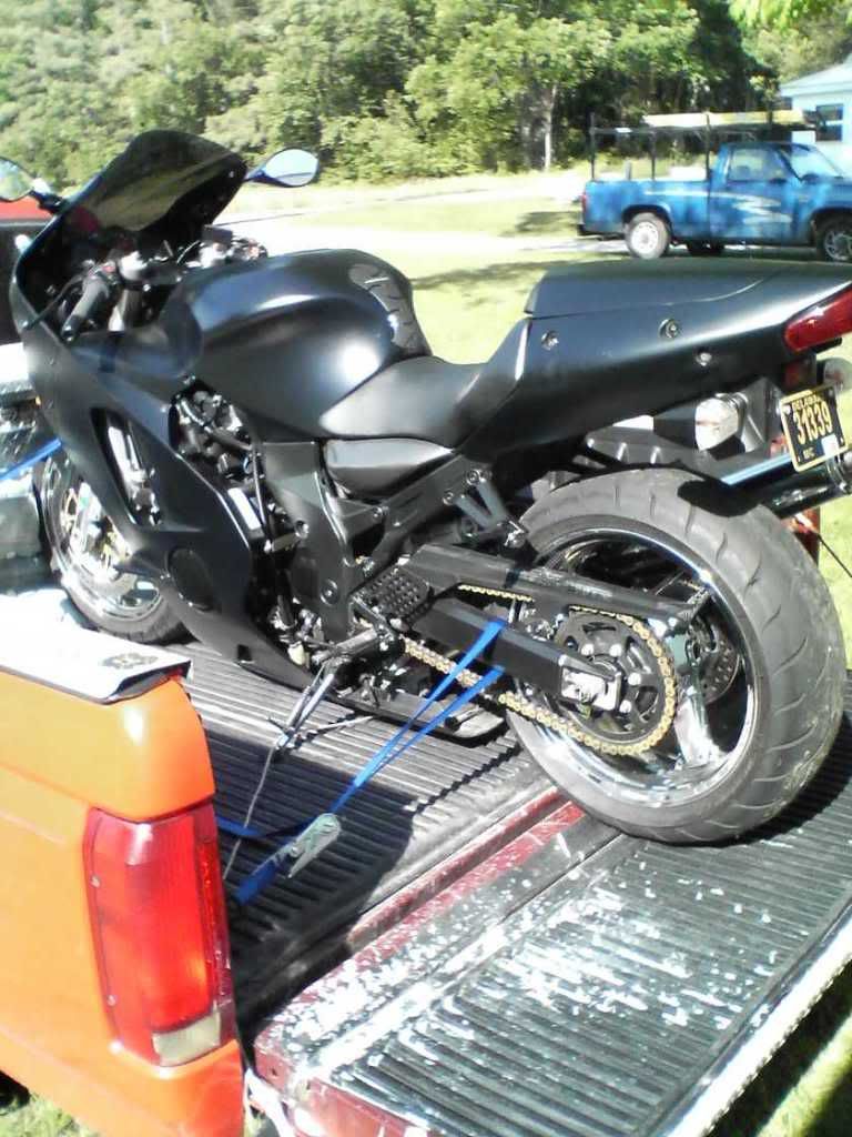

This was how i bought it 4 years ago. I will definately try 11500, n if i can go to 12 that would be more mph n hopefully faster et's

The a/f looks lean as hell...but the black smoke tells me it is rich. Take it to HTP and get a good tune. I am telling you, it can go 9.50's with you on it, with some good$$ gas. The 1/8th mph (114) is real good for the total weight as it is (compared to a stock 12R motor)!
