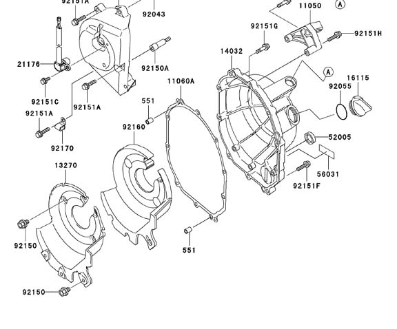

is that bent up part the one in this diagram #13270? if so why is it so bent?

It looks like the big clutch nut is falling off not allowing the clutch to disengage. Remove that cover, remove the pressure plate and check that nut. Clean that metal out of there while the cover is off, drain the oil, fill with cheap oil run it a bit, drain the oil again and change the filter, refill with the good stuff.

I look at those pictures and it looks like there is metal grindings in there. That is why the oil change stuff. A clutch that doesn't disengage acts like you describe.
