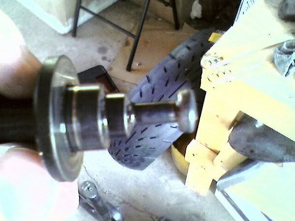

i just replaced the arm and puller on my bike. since there are not alot (or any) aftermarket puller arms and posts that are stronger (harder) my stack hight had to be too low. the clutch of mine was slipping when stock. at about 7000 mi i put springs in then picked up 21 more hp. the last time my mph was fron 142 to 148.05 mph in the 1/4. it is dead and had to be way too short on hight. this new barnet clutch i am going to pay attencion to hight and watch my hardware.i think i paid about 50 bucks for both parts. what sucks now is all dam summer we could not buy a rain drop. now the end of the season and i got a new clutch and am looken for the 9.6s and rain rain rain every day the track is open. i bet it will rain out this saturday at maple grove. rats

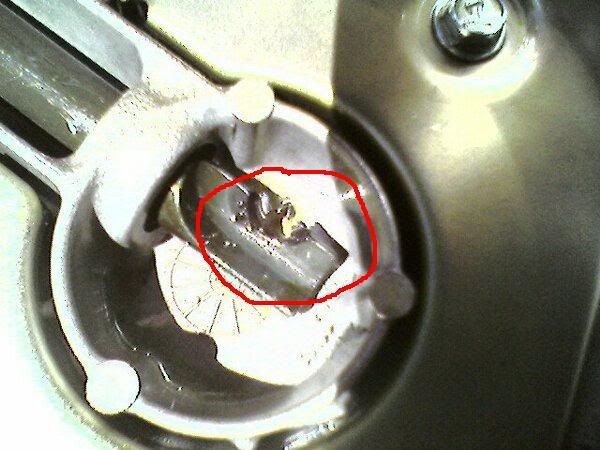

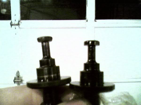

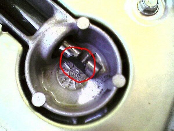

these kind of bad things(my stack height was over 2mm too low):
new part on the right:

That part is notoriously weak.
Some have EDM'd the part to squirt oil on the assembly to keep it cool.
Other than that... its the cost of consumables.
