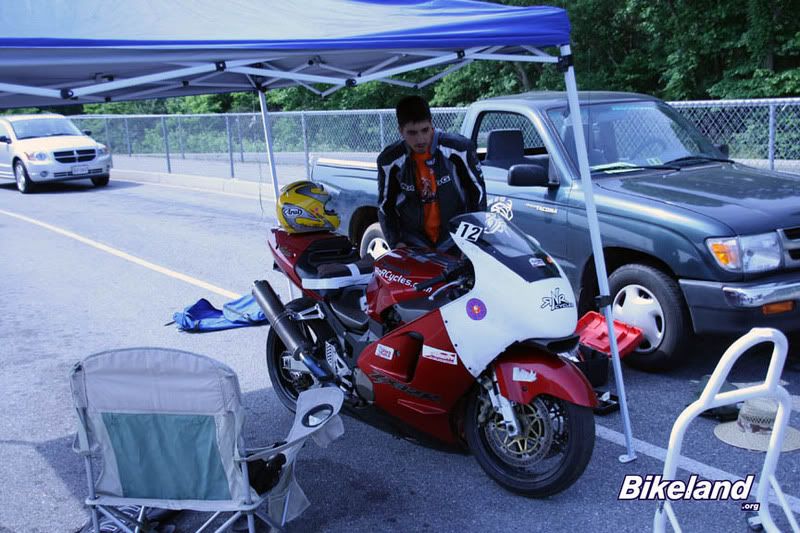

Pic at the strip (airtech fiberglass front upper, full muzzy titanium, carbon fiber wheels, fiberglass drag step seat):
Maxton, naked (no fairings):
Texas Mile (tail shot w/nos bottle):
In a couple weeks I'll have it on the scales again. I want 10 pounds off, NOT EASY but I think I can do it!
