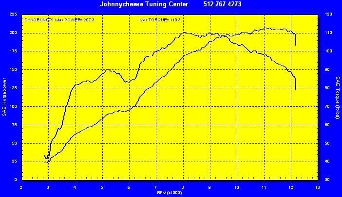

johnnycheese
Posts: 1008
posted July 10, 2007 05:39 PM        Edited By: johnnycheese on 10 Jul 2007 18:40
what do you think

dougmeyer
moderated
Posts: 2713
posted July 10, 2007 09:13 PM
What's with the crater at 6?
That'll run.....

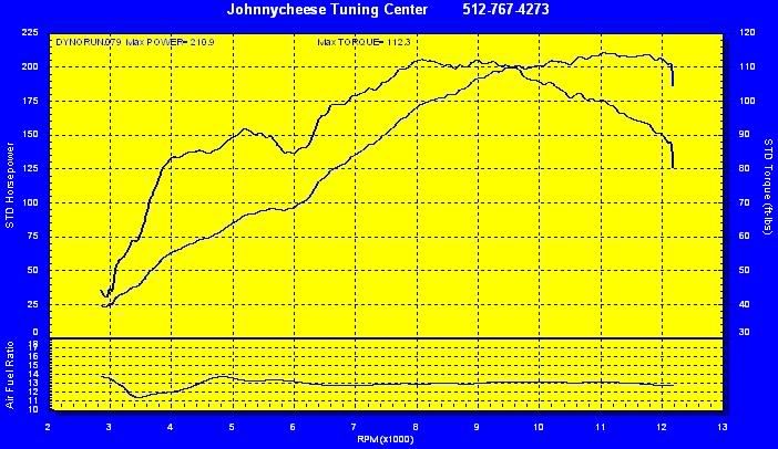

tcchin
Posts: 867
posted July 10, 2007 09:18 PM
Can you repost with SAE numbers?
entropy
Posts: 8671
posted July 11, 2007 01:08 AM
nice numbers and overall shape except that "crater" at 6k; be a challenge to launch smoothly at 1/4 mi.

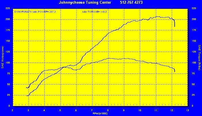

aliveagain
Posts: 5033
posted July 11, 2007 08:41 AM
I thought all motors have the torque and hp cross at 5250rpm.
entropy
Posts: 8671
posted July 11, 2007 09:36 AM
Pete,
they do "cross" (same values at 5250); JC just scaled the hp & tq differently.
But good catch, i didn't notice it until you said it.
johnnycheese
Posts: 1008
posted July 11, 2007 02:16 PM
I can not get the 6K qlich out.
I will repost in SAE for grins
