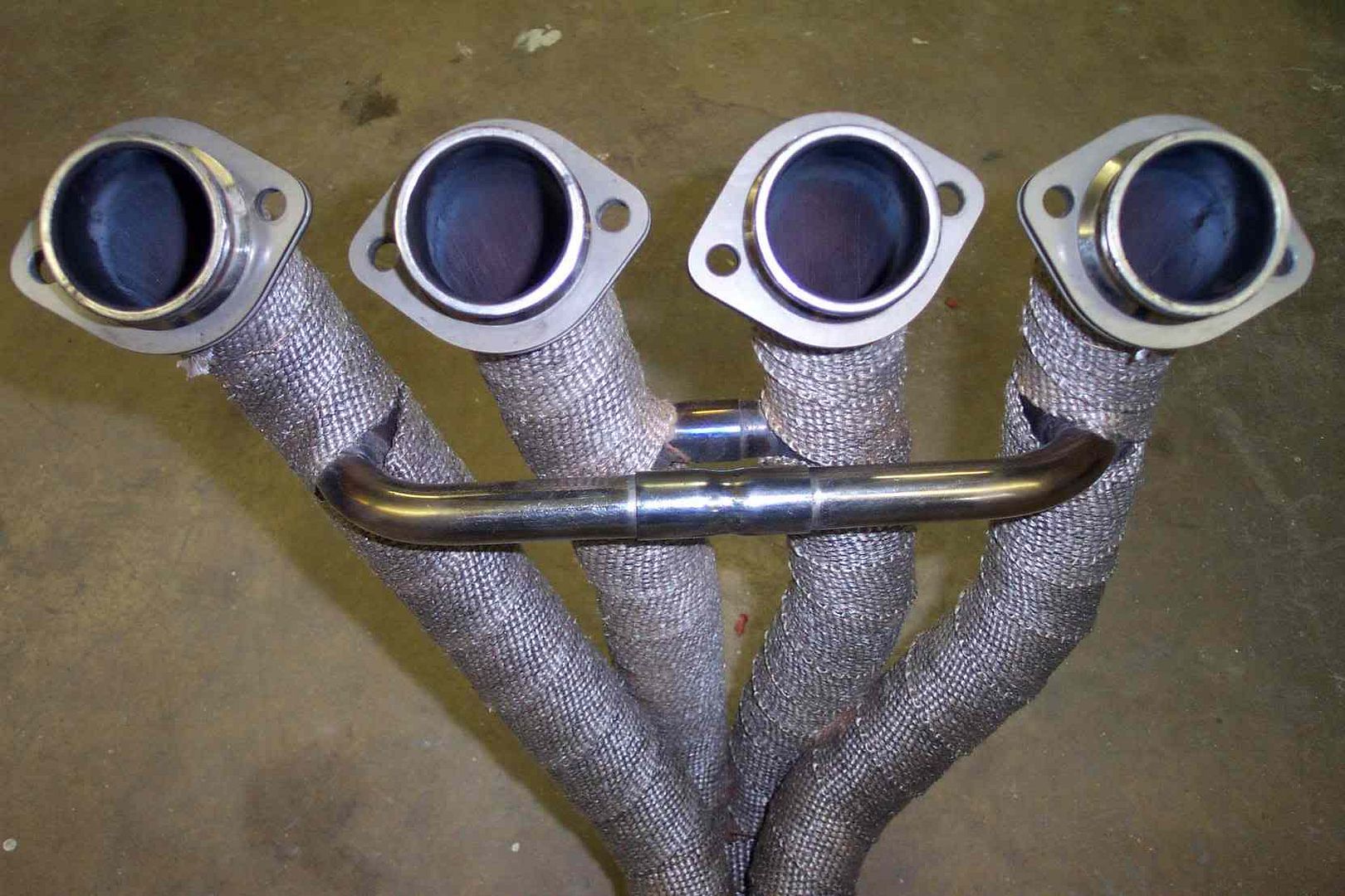

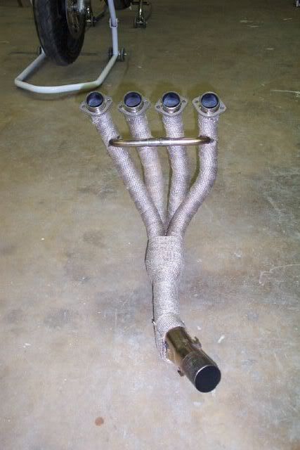

A few shots of my wrapped yosh pipe...

Nice wrap job....Easier to do OFF the bike huh....

Yea you have to do it off the bike or you cant make it come out tight. Tightness is key. I use stainless safety wire to hold it in place.
