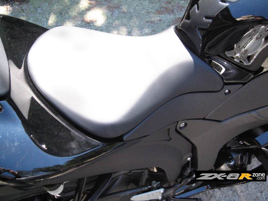

Step One...
Remove your seat...

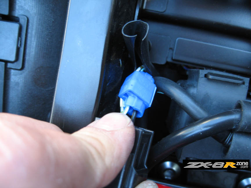

Step Two...
Locate the black connector under the seat (top left corner of the photo)
Step Three...
Free up the connector...
Step Four...
Expose the wires in the harness....
Step Six...
Using a butt-splice connector, bridge the BLACK/YELLOW and GREEN STRIPE/GOLD DOT wires.
You're done! Go ride!

The mod to the ECU for the Kaw has been around a while. Most common is to simply put a "jumper" wire between the poles (as Roadracing World showed). It is simple and "free". I've seen this mod add from 2 - 4 hp depending on the year. No more, no less.

According to that site the mod changes the way the exhaust servo behaves. Supposedly it acts to restrict noise on the US models at the expense of peak horsepower. The link below is to a dyno run graph. They claim an 8 to 9 hp gain, looks more like 2.5hp to me.

Diferent Colors in my wiring harnes
Hey Fish,
The colors in the wiring harness in my 07 zx6r is diferent from the one you posted.
I have:
Black/Yellow stripe
White/yellow Stripe
Aqua/darkturquoise Stripe
Solid Blue/Black dots.
Humm help here please.
C.G
GOODTIMESROLL
Posts: 19
posted September 05, 2007 09:54 AM
Thats the way mine is too. It looks like you want to splice the Turquoise w/green stripe and gold dots to the black and gold. Thats what I'm going to do anyway. I'll let you know what I find out....
GOODTIMESROLL
Posts: 19
posted September 05, 2007 10:03 AM
yep, I was right. It's the one thats caddy-corner from the black/gold. In my case it was a turquoise wire with a green stripe and some gold dots dabbed on.
GOODTIMESROLL
Posts: 19
posted September 05, 2007 03:43 PM
well, maybe not. The bike started after I did it, but it won't start now. I took off the splicer in case that was the problem, but it won't start. I'm probably f'd, cause I've been working on it all night.
