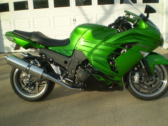

My 2012 has a Boz Bros 06/07 slip on exhaust mounted. It was $100 from Iron Pony. It doesnt fit the 2012 header so I cut off about 2 inches from the mid pipe, inserted an exhaust adapter, 2 1/8" ID to 1 7/8 OD, into the mid pipe and now it fits the bike perfectly. Sounds good and is much lighter than the stock exhaust. The Boz comes with a street muffler or a race muffler. I originally had the street mufflers but have since added the race mufflers which fit the same mid pipes. Neither are loud enough to bother my neighbors.
I also had a set of cheap Chinese imported fake carbon fiber mufflers which cost $60 delivered for the pair. They wouldnt fit the Boz mid pipes so I bought another adapter, $3.50 each, and mounted the pair to the Boz mid pipes. They are louder but have silencers to quiet them. They look good and are very light. I change back and forth depending on my mood...lol.
street racer
Posts: 141
posted January 17, 2014 07:28 AM        Edited By: street racer on 17 Jan 2014 16:09
Here is the Boz Bros street: The race mufflers are 3 inches shorter and have a larger diameter core.
