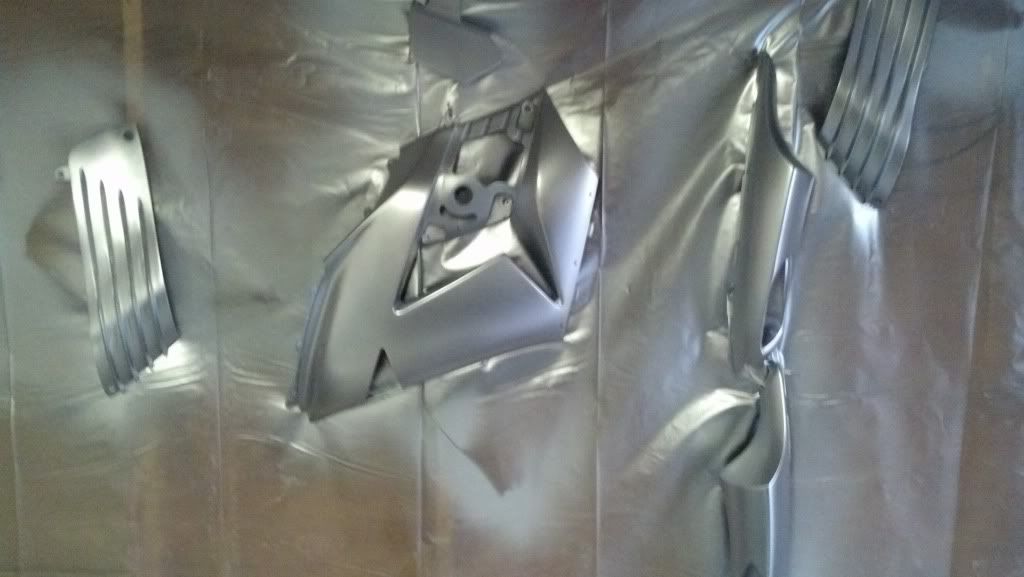

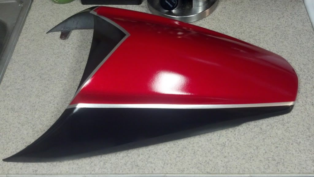

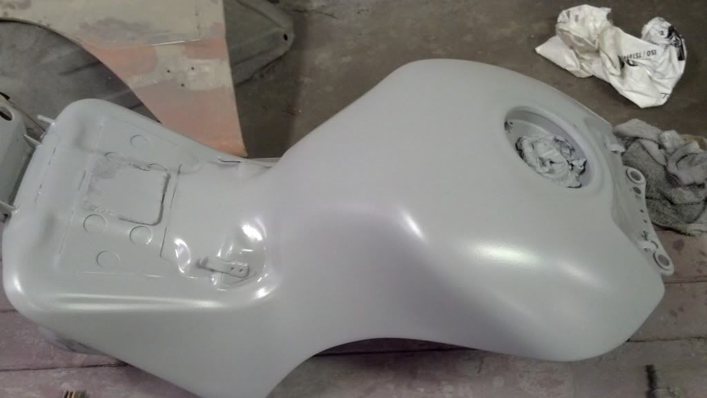

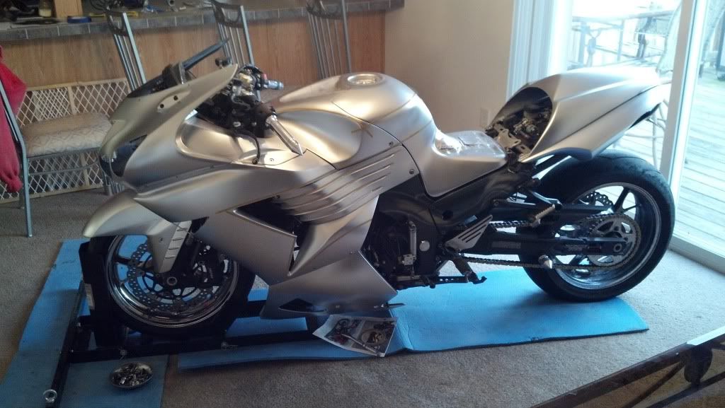

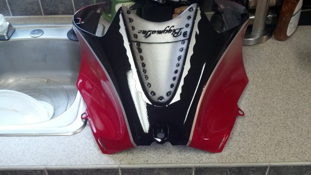

I did try n the only one that bit was in Texas n then he ended uplaying it down, I already started the process, sanded everything to the plastic, primed it, sanded again, put candy base(silver flake) yeah I know, first time painting n he tries candy lol, then marked of where I wanted black to go, sprayed black but the dang silver bade texture showed thru it do I just wet sanded with 1000, repeated black, looks better, then I peel tape off n dang, there is black all over silver from wet sanding runoff, hey, I did say my first time. Now I gotta tape off and spray silver again, then candy the rest, I already did front piece n quickly saw why I should've never tried to sand black of silver n spray candy over it, it really is a see they color lol, oh, n I used duplicolor system, which I don't care for after seeing the red but it is what it is, I'll finish it just for practice purposes but I really want house of kolors brandy wine over black base coat

Very nice , my first time was hok candy . It was a long weekend lol but keep up the good work when u clear it do 3 coats maybe four but wait about 30 min to flash , and wait 12-18 hours to dry wet sand with 1000 and coat again u will be happy

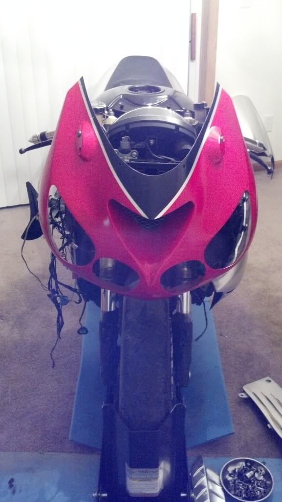

biggmoinc
Posts: 747
posted January 19, 2013 04:54 AM
07 ZX14 bmc filter, muzzy m14, 16/44,66",auto shift, 6'3, 204lbs/1.54/3.99/6.03@120/7.8/9.32@147
biggmo@aol.com

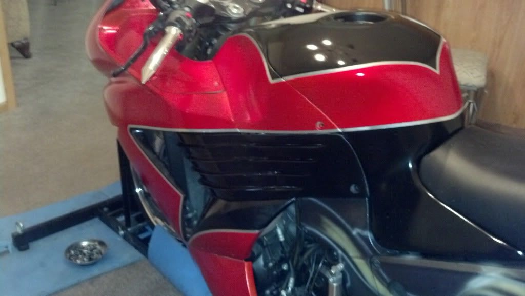

biggmoinc
Posts: 747
posted January 19, 2013 04:57 AM

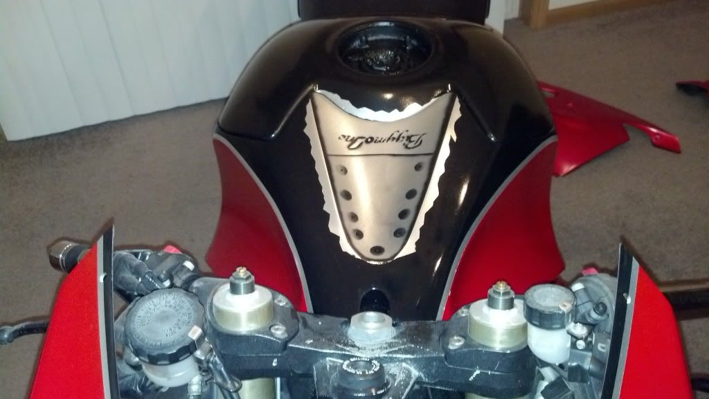

biggmoinc
Posts: 747
posted January 19, 2013 04:59 AM
biggmo@aol.com

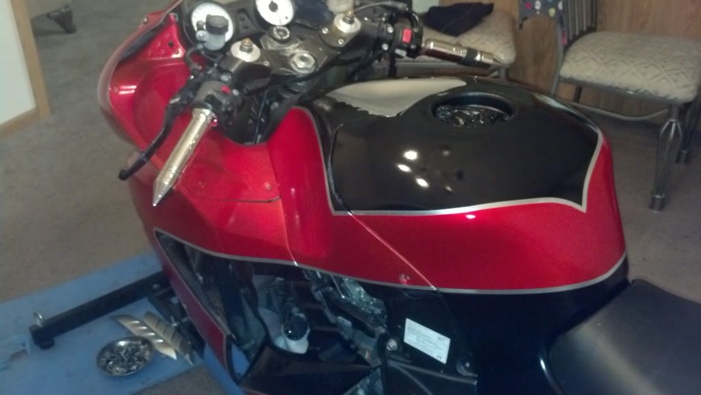

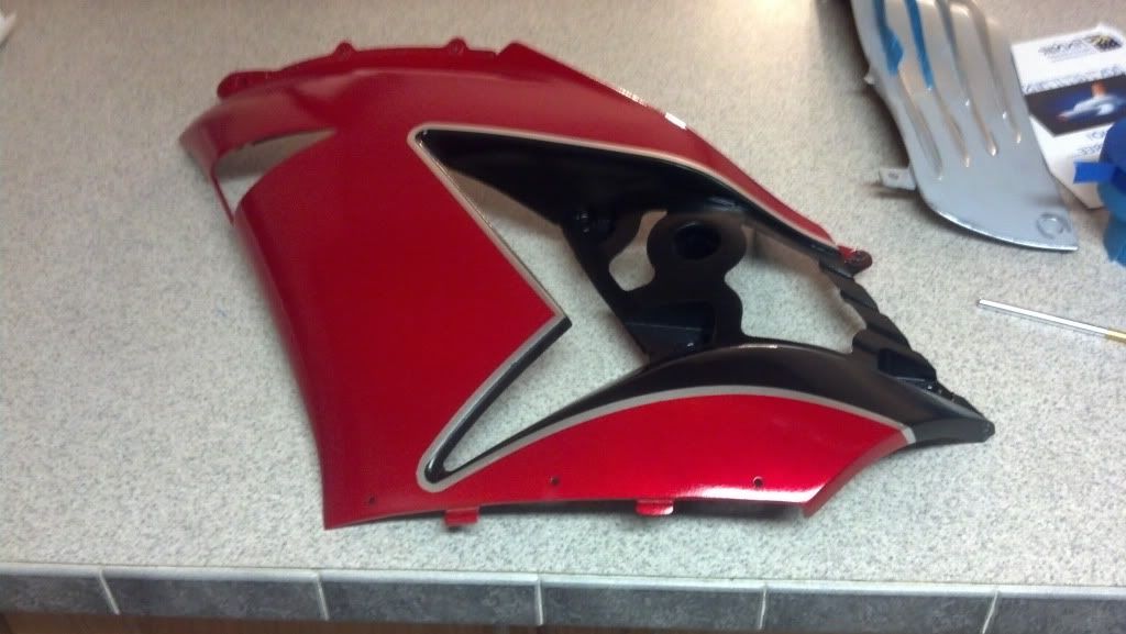

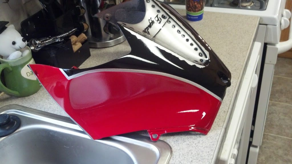

biggmoinc
Posts: 747

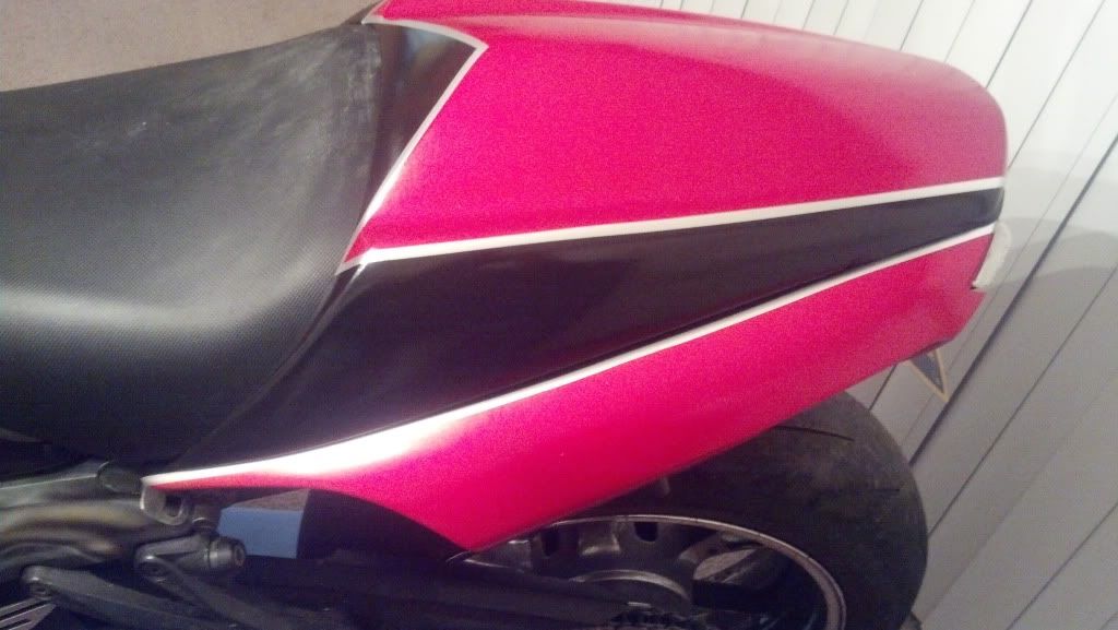

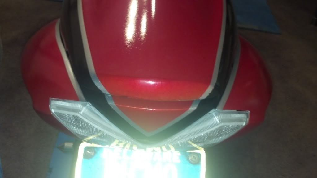

posted January 19, 2013 06:00 AM
biggmo@aol.com
joseph702
Posts: 598
posted January 19, 2013 08:00 AM

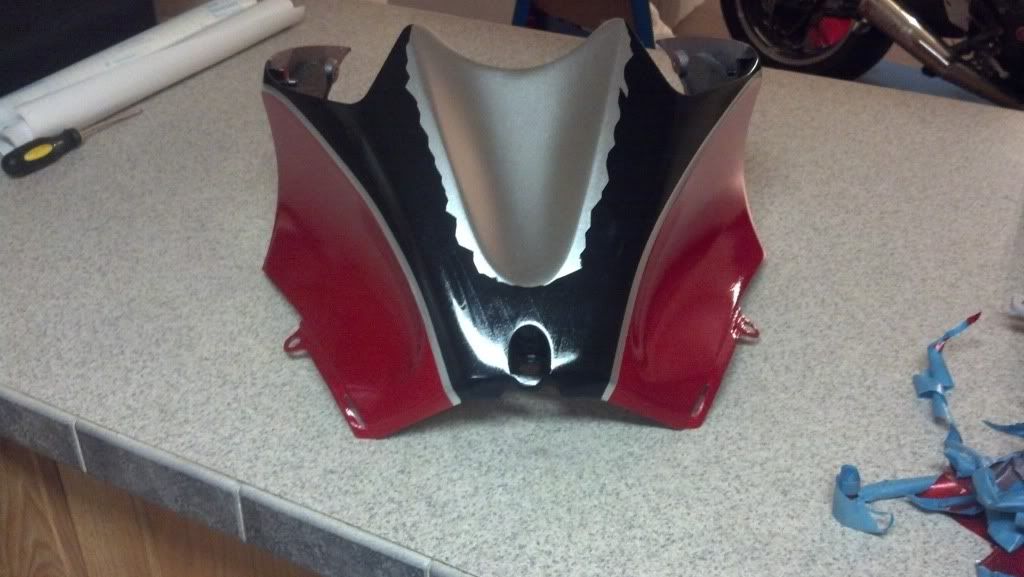

Looks good , is that's base coat clear coat or a single stage paint?

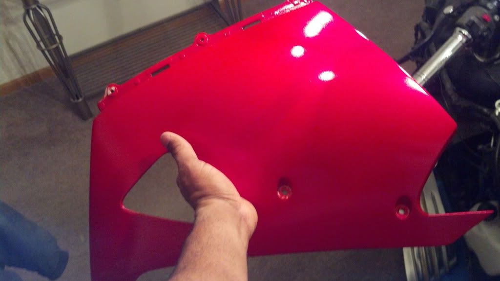

biggmoinc
Posts: 747
posted January 19, 2013 05:57 PM

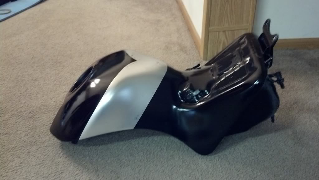

No the base coat is a really heavy silver metallic I made the mistake of painting entire bike with it before taping off part to b sprayed black after spraying black the texture from the metallic showed, n boy did it show, so I wet sanded wit 1000 n resprayed black
Thanks!!
Looks better in pics though lol

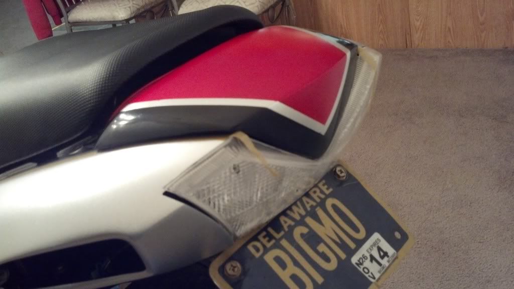

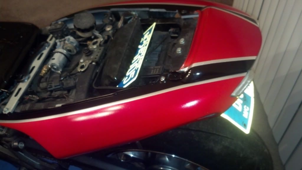

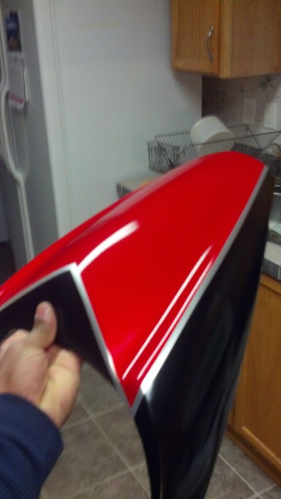

biggmoinc
Posts: 747
posted January 19, 2013 06:06 PM
biggmo@aol.com

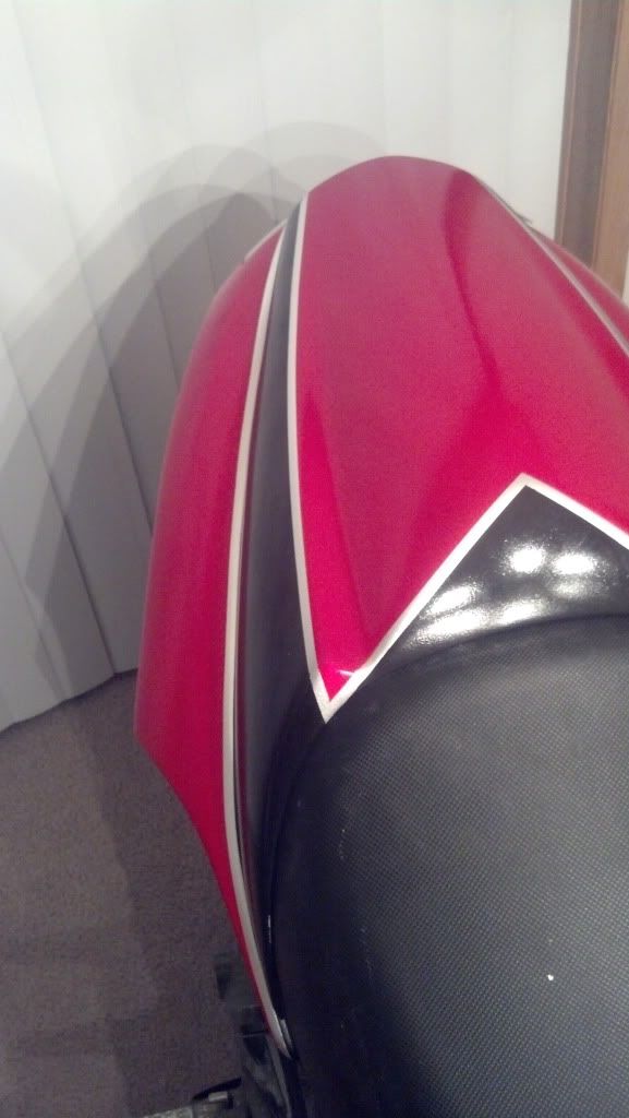

biggmoinc
Posts: 747

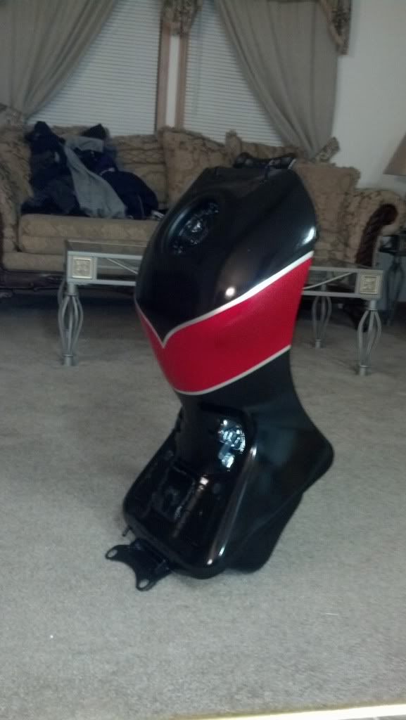

posted January 19, 2013 06:11 PM

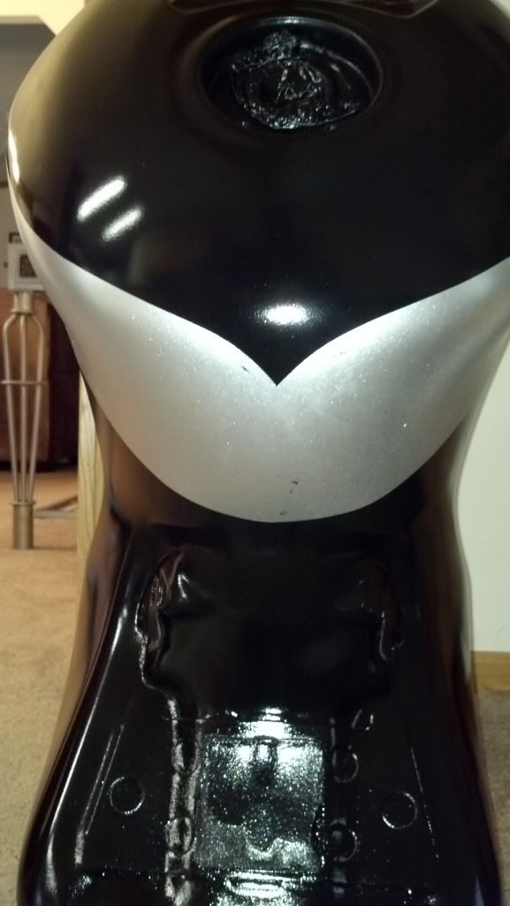

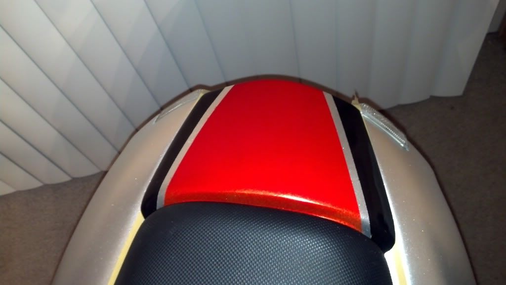

Got to tape off fins, not sure if I want to do them all black or black n red, the 2 rear side panels n the front fender, then the frame has to be done cause the last custom job they painted the actual frame as well. Then I'll wet sand everything n clear the heck out of it, I put 1 coat of clear already so that if it gets a small scratch while handling it I can sand it out, almost there!!

joseph702
Posts: 598
posted January 19, 2013 09:01 PM
Black with read fins like its ripping thru would look sick
joseph702
Posts: 598
posted January 19, 2013 09:06 PM
Bike looks really good . I can paint really nice and get a show gloss but man u can tape . I can't get tape lines like that to save my life . Hands to shakey . Boxing for 10 years hurt my hands a lot .

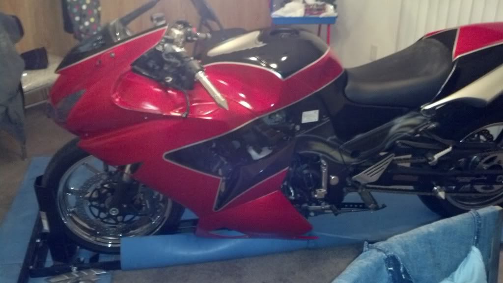

biggmoinc
Posts: 747
posted January 20, 2013 05:25 PM
Can't take credit for scheme I looked at 300 or so bikes , it was a toss up between 2 bikes. Two that I thought I could do, decided against the busa cause I needed smooth side pieces to pull it off so I used a black n gold drag 14 as a template, all I changed was the tank n rear seat cowl, other than what I can see in the pic, besides the color,
All props go to this bike, whoever it is I thank u!

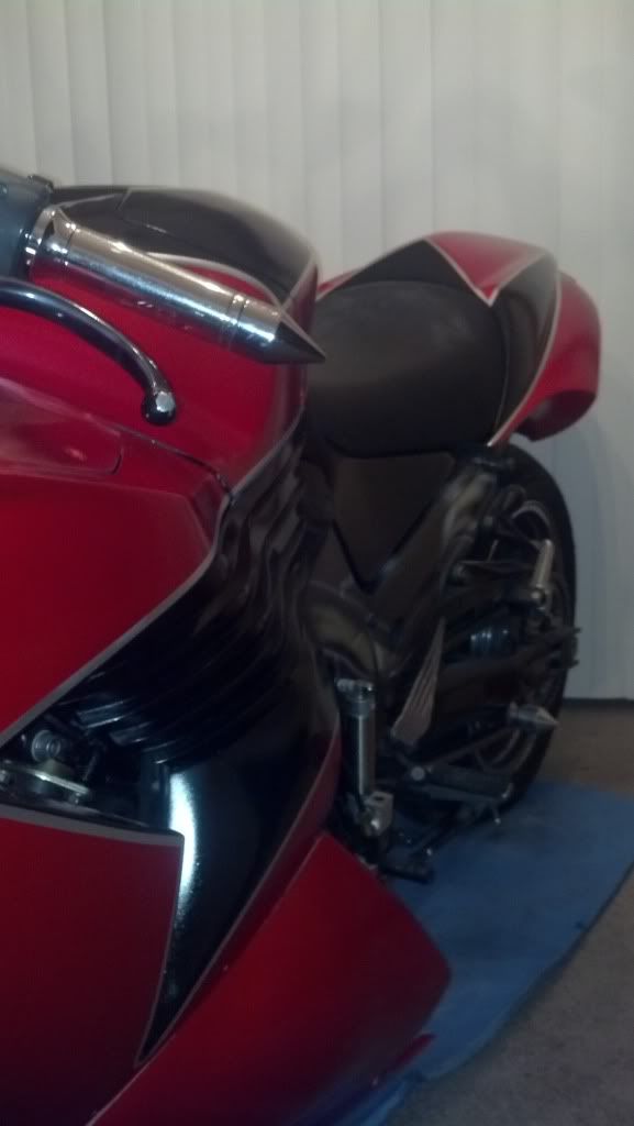

biggmoinc
Posts: 747
posted January 24, 2013 06:52 AM

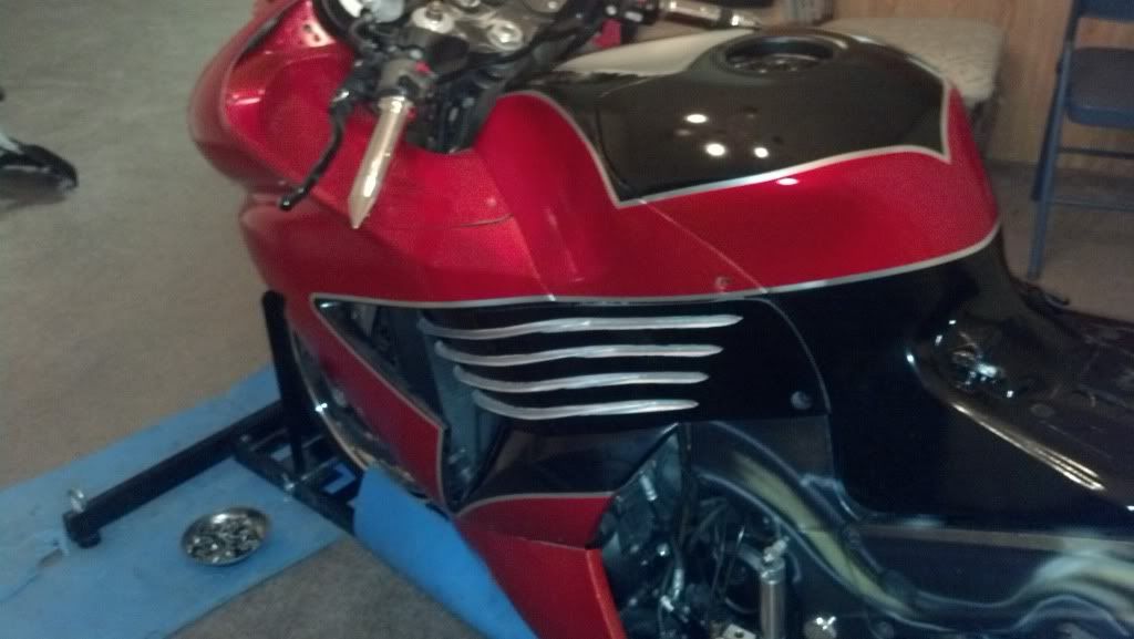

Here's black n silver pics of fins , which do y'all think or should I do the candy red fins, no pic of that though,

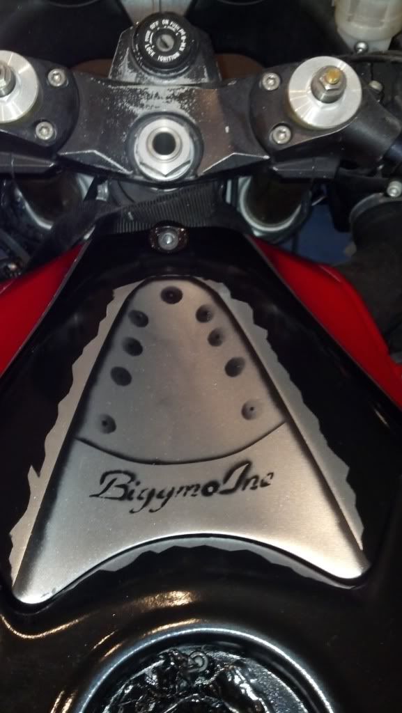

biggmoinc
Posts: 747

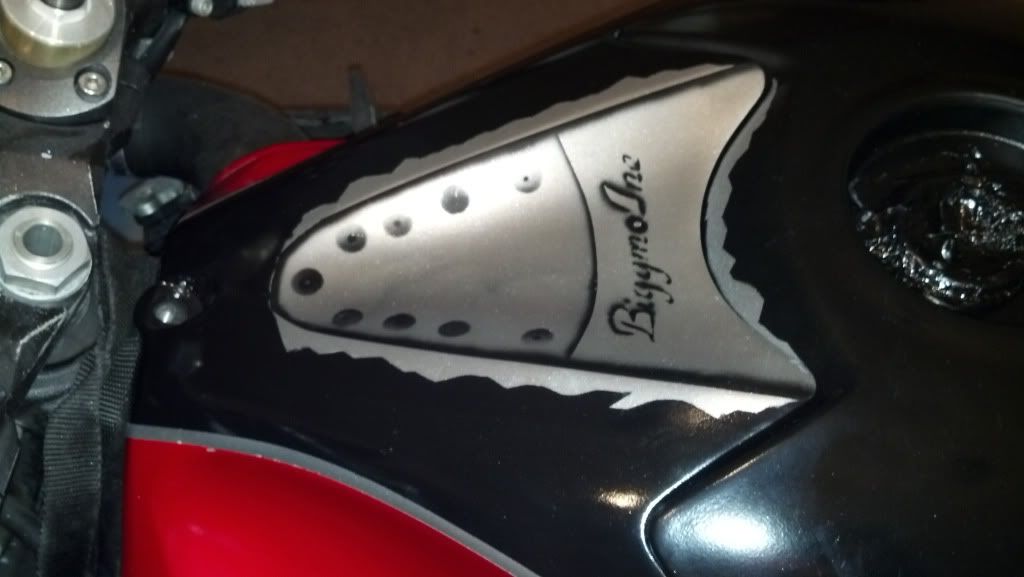

posted January 24, 2013 06:58 AM
Also tried to (so called) airbrush, instead of buying autoair or hook airbrush paint I thinned the black lacquer paint ith thinner n it sprayed good until cobweb looking stuff was flying over theplace, not sure if air was drying paint as it came out n caused this but it clogged my stencil up several times, should I leave it like this or go over it with candy red, it'll still show through fairly good s candy is transparent n black under it really shows up
