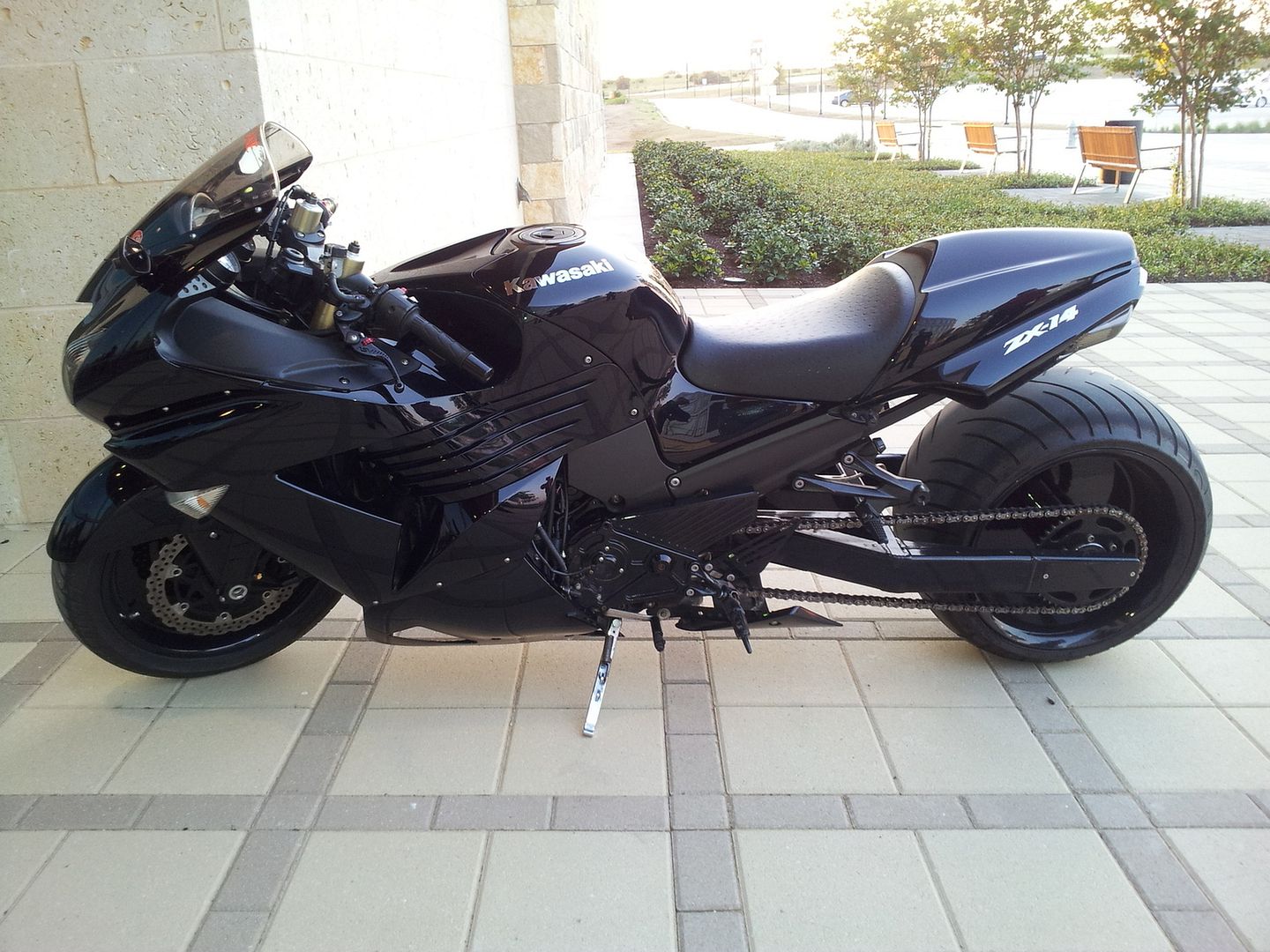

Looks like this when you're done, looks way sleeker & keeps temps down too.......
I made my own brackets out of sheet aluminum.

Beautiful machine. Who's swingarm are you useing ?,8 over or 10. And 300 tire? Clean ride

Thanks! I have a roaring toyz 330 osd kit It's set at 10 over

That fender mod looks great

It was sort of a bitch cutting the brackets with a shit hacksaw but it turned out good. Maybe one day when I change tires I'll take a pic as I have to remove the fender to get the wheel out anyway.
