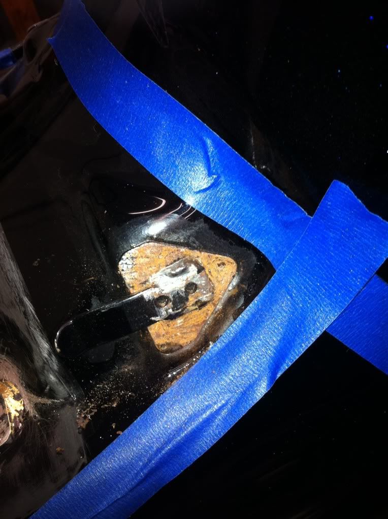

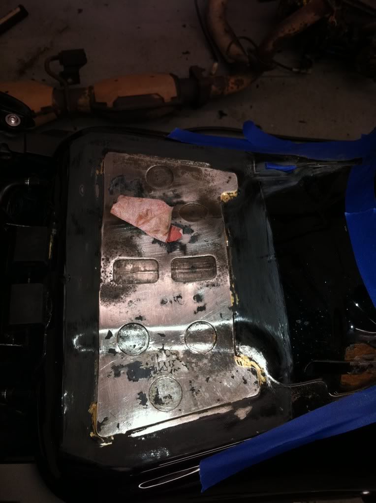

Here are a few shots of the rust dammage areas being repaired for now untill I can find a good replacement tank, before I started picking and sanding it looked like very minor rust (streaking stains on paint, pitting) but hiding underneath is cancer! and lots of it.
The first is the tank pad area under the seat, I had to remove all the old paint.
Next you can see the rust around the seat hooks.
Last is the rust spots and bubbling on top of the tank on and close to the filler neck, it is doing this in many places on top of the tank even far away from the filler neck.

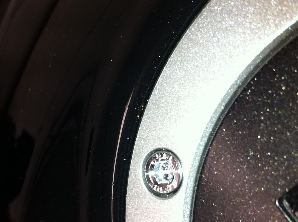

Update. The spots around the gas cap are not rust. They are spots where the paint did not adhere to the tank, the metal is brass in this area??

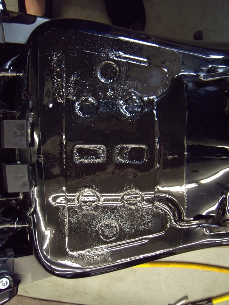

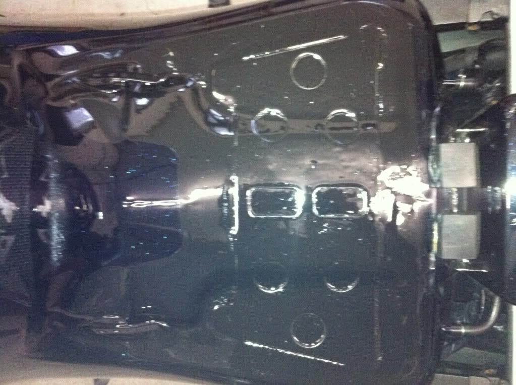

Also finished the rust damage on the tank under the seat. Took the whole areaa down to bare metal, nice tape job, 30 min of metal ready, then 2 LIGHT coats of POR-15 black. Turned out way better this time, took my time masking and did not rush the painting or put it on to thick like last time.

I have lived all over with my 08, Houston, St. Paul MN, Oak Harbor WA, ALBQ NM never left outside, keept clean as can be, with a dry wash after every ride and a wet wash after driving through rain or once every few weeks or so. As you can see from this post ive repaired mine well with por-15. And what I thought was rust around the gas cap was the brass brazing showing through in a few spots where the paint did not stick well. (pin head sized spots). If your bike has ever been wet, peel off the foam on the tank and I bet you find some degree of rusting.
