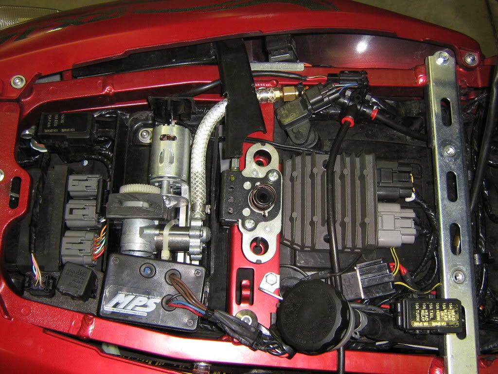

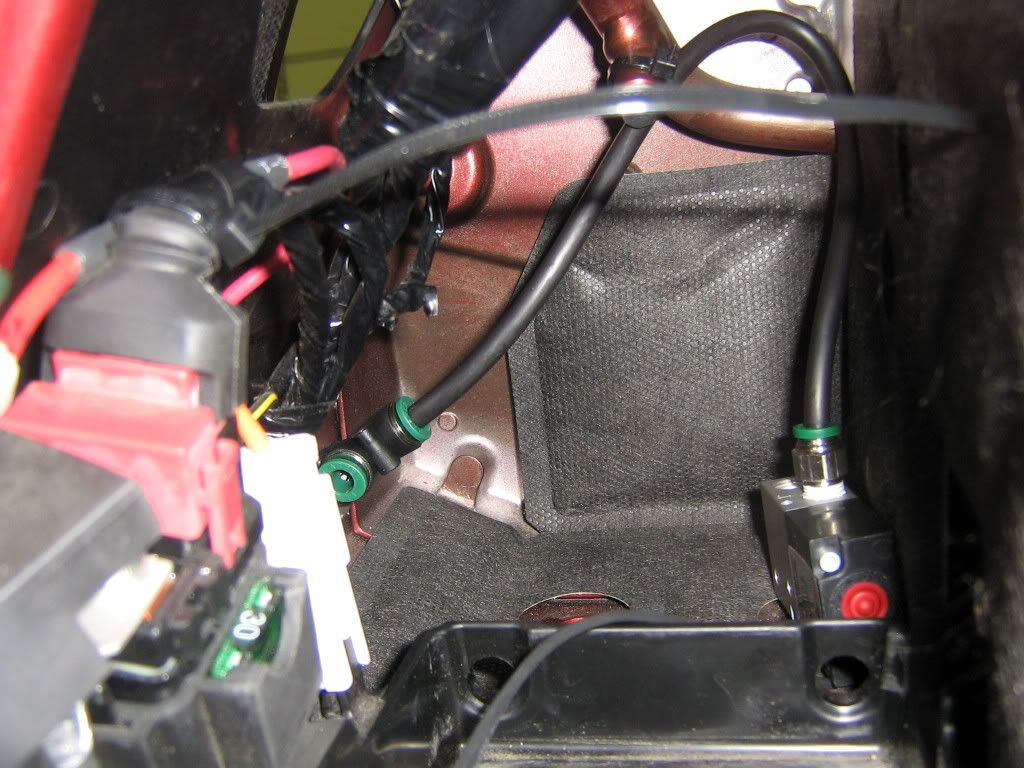

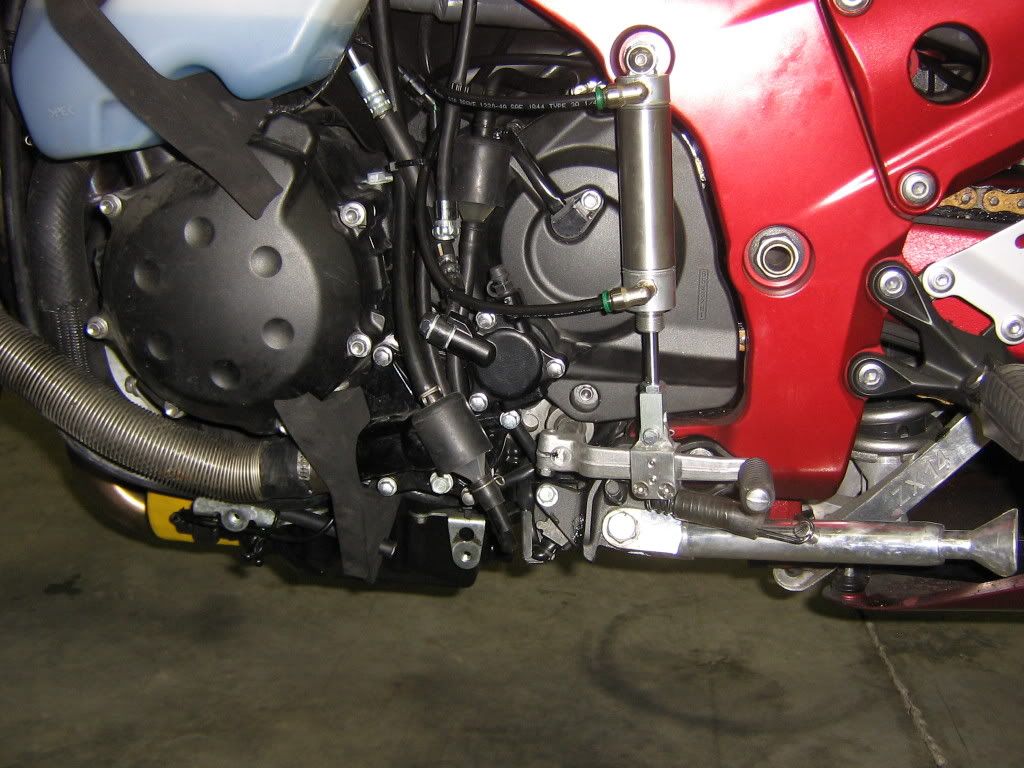

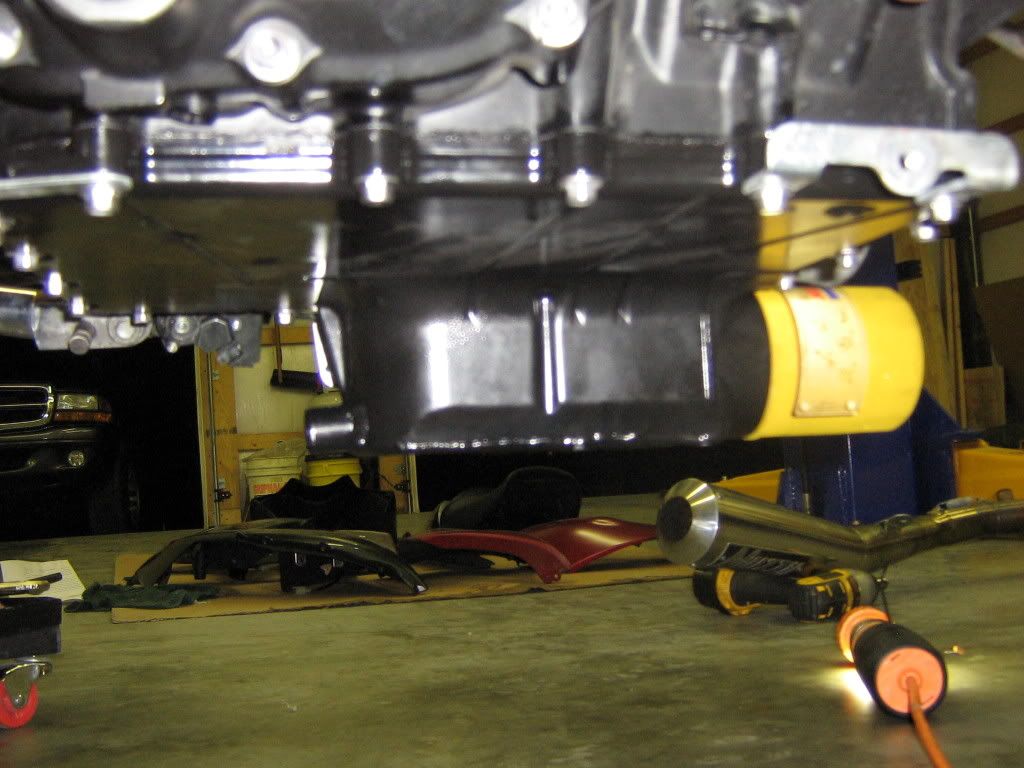

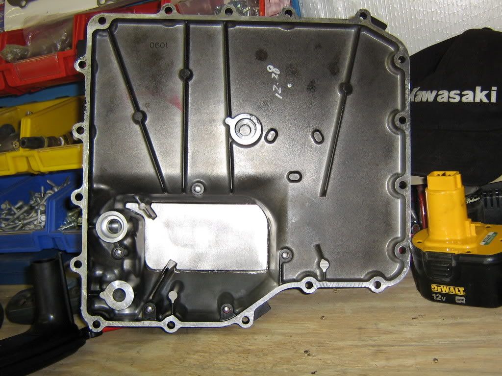

weekend project air shifter,cut oil pan
mps air compressor and kill box
battery box put the solenoid
air shifter
clearance with clems cut pan installed

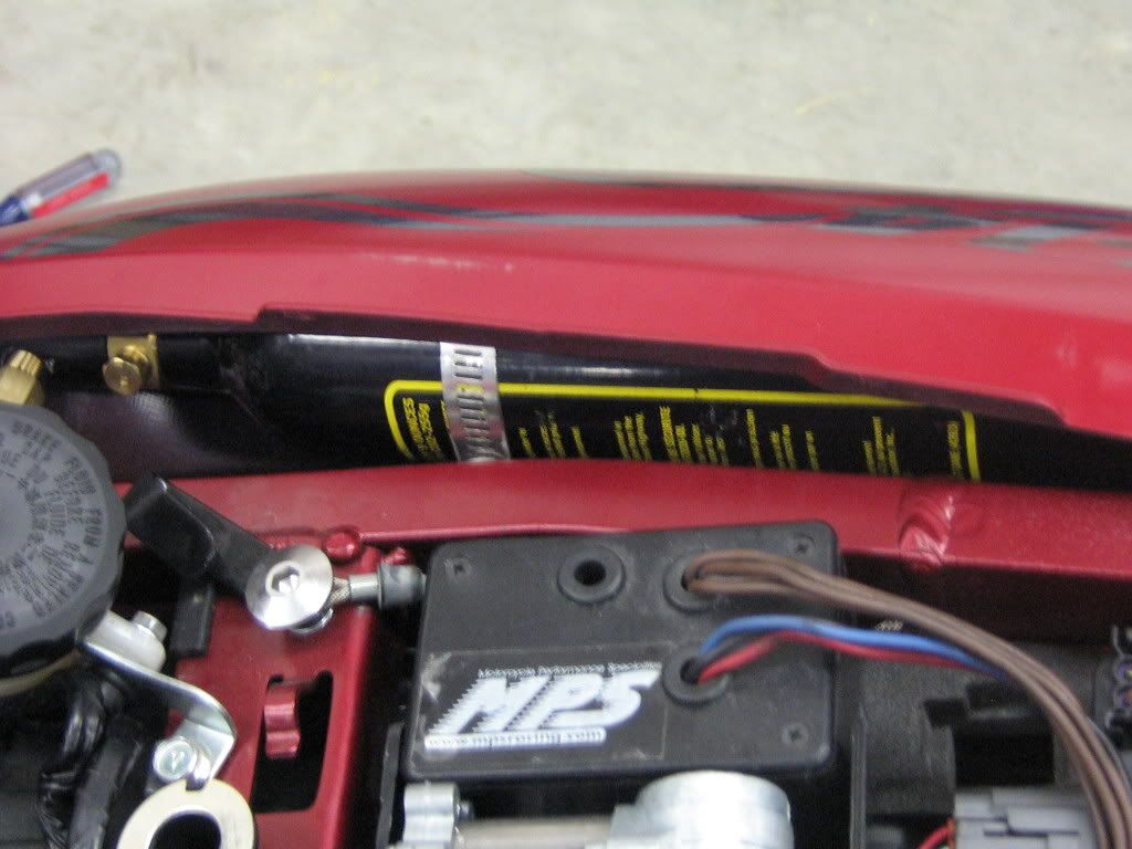

9oz bottle in side of back tail

8.89 mph 151.32

posted April 20, 2009 05:26 PM
Why do you have two hoses hooked to the Ram ? You only use one ...
Smokin Performance Cycles..
Wheelie
Old Man
Posts: 6902
posted April 20, 2009 05:29 PM
keep debris or water out?

posted April 20, 2009 05:31 PM
Wheelie said it to keep water out

what did you use to hook your air lines to the bottle--- it is a co2 bottle isn't it

posted March 05, 2011 02:38 PM
Why is there a compressor and a co2 bottle? Looks good though

posted March 05, 2011 02:56 PM
low pressure tank?

Posts: 6046
posted March 05, 2011 05:37 PM
The tank is small enough to fit in his tail section.

osr
Posts: 459
posted March 05, 2011 08:39 PM
thats a good lookin pan!
