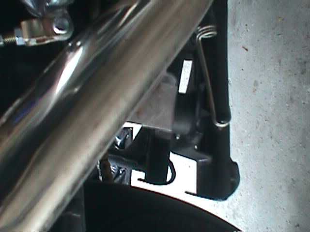

Here is a pic from the side. I will get you one from the bottom as soon as the battery on my camera is charged. Stevewfl is correct about the exhaust, but I suspect it can still be done with a modified exhaust, just have to build the bracket to dampen the sound and keep the centerstand in place.

Here is the pic of the folded up centerstand. Easier to understand if rotated 90 degrees.

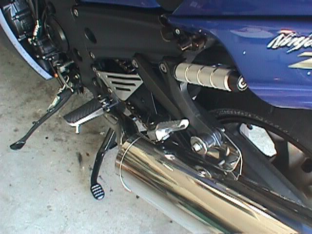

I just had the welder cut the stop off the centerstand and weld a straight stub about 4 inches. With a rubber end it sits nice and tight under the swingarm. This was a far less easier way to go then to weld some stop on the muzzy. (which sits further away than the OEM connector pipe where the centerstand stop is supposed to hit.

Guess I should reduce the size of this pic first. Wow!! its huge. I didn't know I was leaking oil

Dual slip-ons. The fix is on the right side of the centerstand where the OEM stop used to be (closes to the gas pump side) prior to it being grinded down (off). When retracted it seats directly under the swing arm. The pic makes is look closes to the camera but its on the other side (where a single sided exhaust would normally be)
It took all of 20 minutes and $30 for the OEM stand to be have its stop grinded off and the 4 in. stub welded on. When the whole stand is coated it'll look stock. Its really an easy fix.
