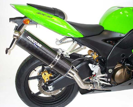

Micron has a pipe for ZX10

I like the looks of the can on the R1 better than the 10R. I dont like microns carbon fiber looks that much. They have better looking allum cans.

Very nice. R1 looks real. The 10 pipe looks like a photoshop job.

Does it not look like it's bigger than the stock can?

It does.

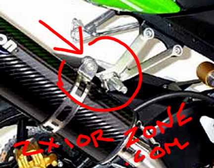

I'm with kbryant.... "It's a fake"
I guess Micron pipes just "hang" on that bike by the sheer force of pure magic !
Pretty weak if ya ask me... they couldve at least waited til they made the product....
