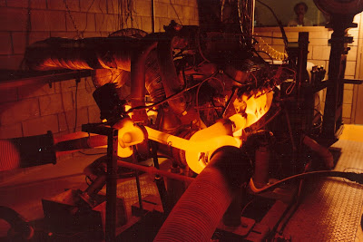

Shane, the engine was dynoed on an engine dyno. Two of them, actually. I used to use the Stuska at Bob Wirth Racing in Hayward Ca and the last time I dynoed it, in 1999, it was on the Muzzy's Eddy Current setup. Until Dynojet perfected their electric absorbsion unit, there was no other way to do any real development, where you could hold the engine at full throttle an a given RPM for an undefinite length of time. I guess a lot of you have never seen a "real" dyno..........
Doug

dougmeyer
moderated
Posts: 2713
posted May 31, 2009 03:38 PM        Edited By: dougmeyer on 31 May 2009 23:42
Here's a REAL dyno:
That's a 500 inch big block Chevy turning out 1200hp. You had to get used to walking in there.
