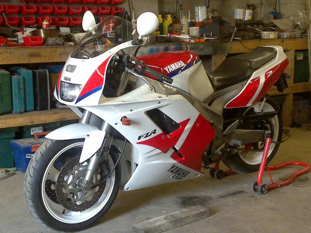

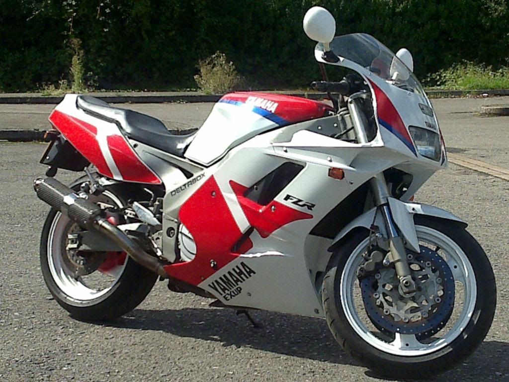

I'm not a professional painter, which may be part of the problem, but have been painting for 20 years or so.
Here is a FZR I painted for a mate last year http://i1238.photobucket.com/albums/ff488/MarionPotter/Bikes/24082010060.jpg
http://i1238.photobucket.com/albums/ff488/MarionPotter/Bikes/24082010052.jpg
Thanx for your input, and hopefully PPG will come through for me.
