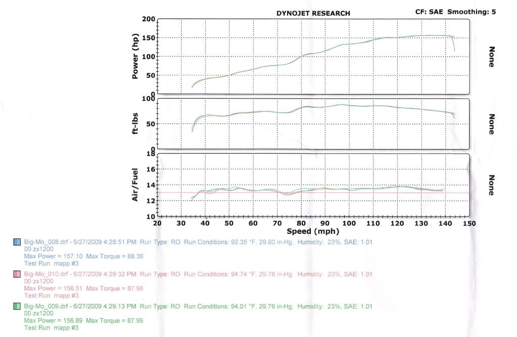

stock had 152 n 83ft. After pipe n pc3 bike161 n 86. Rebuilt wit a 1270 n adj cam sprockets cause number 3 wall was badly gouged. Bike had 171 wit 96ft wit a decent tune from Hovey performance. botttom half took a sh#$ after 1 year. Went to change oil n had silver in the oil. So.......rebuilt top to bottom. After break in bike had 168 n 98, granted this was a different builder n tuner. He has been building for alot of years n was told he was very good however his tuning skills on the dyno r fresh. Anyway i lost the map that was in pc3 n tried a friends map (thanks again KZ) bike had 152 n 84ft. He played wit it for 6 runs n ended up wit 157 n 88. I know the tune is off but what the hell happened to my 170ish. I thought i wouldve had 180 something since on the last buildup i had the head cleaned up. I live in Delaware n i m looking for a dyno specialist or datalogging guru. Rather have real world power n not favorable dyno numbers, but this sh$$ cant be right. Bike blows black smoke when ran hard WOT. Doesnt feel like its missing or running bad just not running to its full potential. Bike has bout 4500 to 6k since last build. Doesnt burn oil just seems like it runs rich but A/F looks like its almost round 14 in some spots. I just put the muzzy advance to 3 or just a little past midway of the first line. GUESSIN GAME WIT THAT INDICATOR ON THE MUZZY. Havent ran it on dyno wit this but it cant hurt. Anyway i was in 5th gear n my friends 1k was in 6th n he still pulled away from me, n i m mad as hell, lol. After all this engine build i m not happy. Any suggestions. I m hopin something simple is keeping it botttled up! Again looking for a real tuning specialist close to delaware, hell i will go further if thats what i got to do, lol. Thanks again KZ for all ur help, i appreciate it!

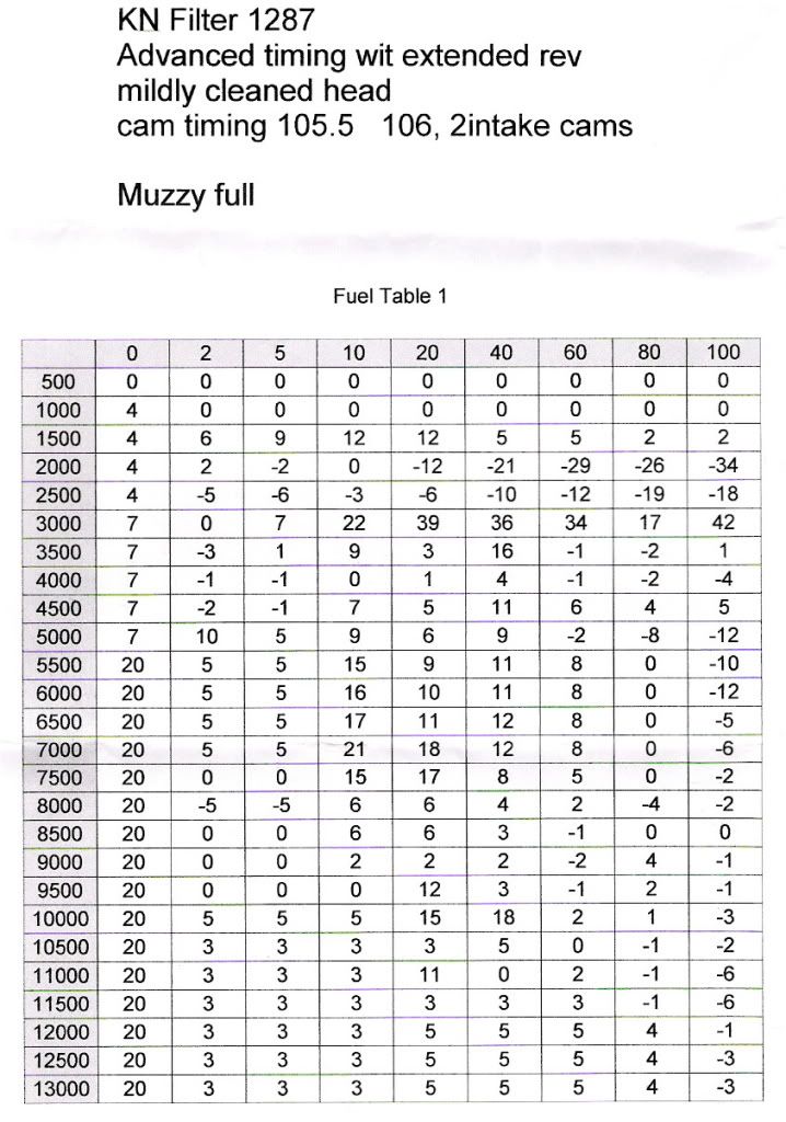

Current Map
current map

The cam timin n extended rev is not my own, just what the map was previously for. He was runnin bike up before the rev kicked in, says he doesnt like to run em up to rev limiter. Cant say i m mad at that

Get it tuned by a competent tuner. Your a/f looks really bad, so don't be discouraged by the numbers you have now.

Not to rain on your parade but those HP numbers seem very low. I can honistly tell you my twelve with just a muzzy pipe on it mad 171hp! The air fuel doesnt look good either. I run mine 12 to 1 at the track 13 to 1 is to lean!!

I think you are freaking out more than you should be. The rear wheel is eating a good 10+ HP. How much do you weigh? Stock motor pipe/pc3/filter I was going 118 in the 1/8 but I'm 120-ish lbs!
We have normal street compression ZX-12R 1427cc with about 200 RWHP and 1397 Busas near that too. Your numbers don't seem that off. Just sounds like you need a good tune. One chart was too rich, one chart was too lean. Get the a/f down first and go from there.
Those big wheel/tire kits EAT HP.
