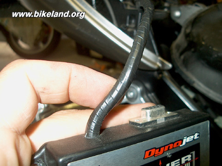

Physically the units are quite different. The old PC3R looks like this....

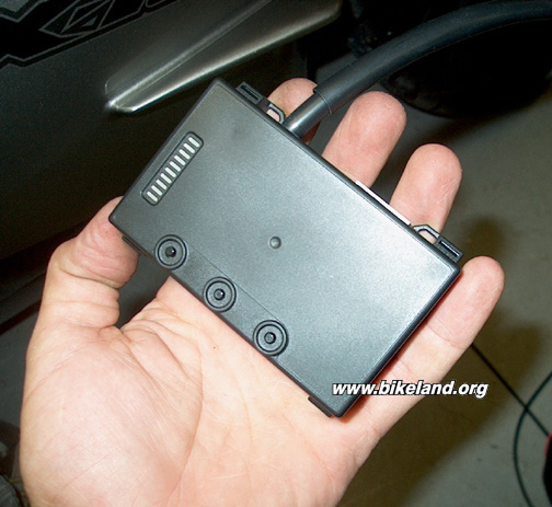

The new unit is smaller, has different mounting points (small slots on this sides, which I used cable ties/ "zap straps" to affix it to my DinoSeatHinge). Note that the preproduction unit sports no markings or part #.

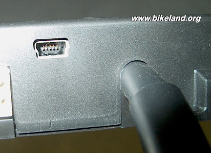

Here is a close up of the USB port...

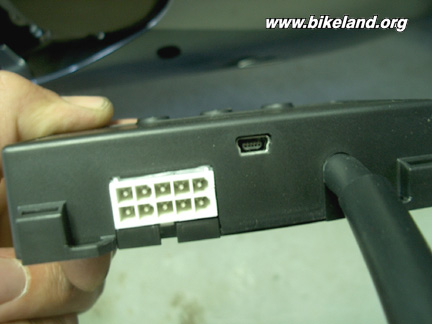

To the left of the USB port is the expansion port so that you can plug in your ignition advance module and the other modules of which I cannot speak
One of the most noticeable differences between the old and new units is the wiring harness. It really makes to old one look pretty bad IMHO.... See for yourself..
The shielding is substantial on the new unit...

The shifter is ready to rock for all pc3usb units. I haven't taken the time to put a shifter on my bike yet so there you go. So order one of the zx12 kits and show the world.
The ign module is in development. Can't say when the expected release date is but we are working on it and should be out soon (ish).

I should clear this up. I don't know if the prototype that I sent Fish is actually smaller or if he still has too many senoritas on his mind, but the Usb unit is actually slightly larger than a pcIII/r. The mounting tabs are for mounting straps and the cable is protected much better and over all is a cleaner unit.

Is that USB 1.1 or High Speed USB 2.0?

hmmm... I couldve sworn it was smaller.... I'll go and take a peak when I get a chance....

It uses the standard Usb and HID drivers from any Windows version 98SE and up. We have included a set of drivers on the cd for those of you that don't have your windows cd. Full Speed Usb (not High Speed 2.0).
