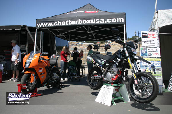

Many of you saw our KLX330SM on display in the HJC Chatterbox tent at MotoGP at Laguna Seca. Here's a breakdown of how you can build what the Japanese don't (yet) . It may cost you a bit of money, but don't worry - you don't need to go as far as we did (we pretty much doubled the value of our donor bike). None of the mods are extremely difficult, and there's nothing you can do that will make the performance less than what you started with.

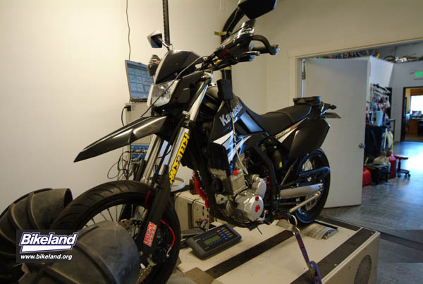

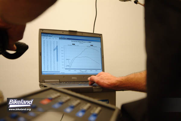

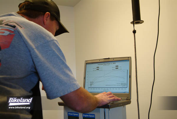

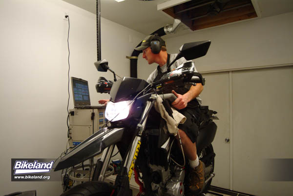

Our stocker confirmed that my butt-dyno is still working properly - on M-Tech's Superflow it wheezed out a measly 18hp. This may work for an entry level rider or getting from A to B to run errands, but any seasoned Kawasaki or Supermoto fan will be disappointed as the 250SF in stock form lacks the aggressive and exciting edge that we all know lurks in the DNA of Kawi's products.

M-Tech
What they supplied...
Hard work!
M-Tech is based in Bend, Oregon and is headed up by Matt Worbes, factory tech for an impressive list of race teams including Rockwall Honda and Proton Team KR.

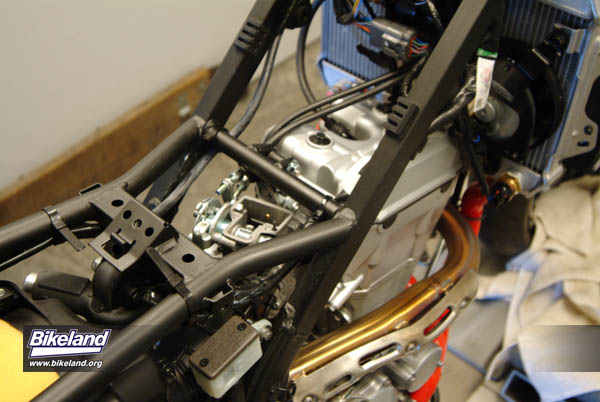

Working with the guidance of Bikeland's mechanical expert and land speed record holder Doug Meyer, Matt gutted our brand new KLX250SF, stripping it down to nothing, then rebuilt it with all the bits that follow.

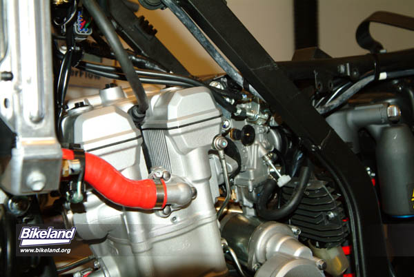

330cc Engine Kit - Kustom Kraft is a totally awesome niche parts shop that supplies pre-configured big bore kits for most late model singles from all the OEMs. The kits are reasonably priced and come complete with gaskets and all the bits you need to make a step up in displacement and power.
This specialty shop has been around since 1995 and they know what they are doing. This is bar none the quickest, easiest and most inexpensive way for you to make power with your stock bike, whether it's a Kawi, Honda, Yamaha, Suzuki or KTM.
Our Kustom Kraft powered KLX has been running flawlessly, and we can't say enough good things about them.
They are your shortcut to eliminating weeks or months of guesswork and part matching to get your engine into the power making department.

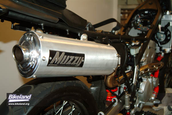

Muzzys Performance Products

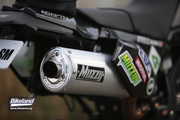

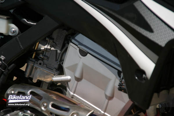

Muzzys full system with stainless headers and an aluminum can. Adding the system shaved several pounds and helped uncork the KLX's engine. The stock headers are so small in diameter they could easily double as a drinking straw.
Rob Muzzy is an awesome guy and his decades of experience in this industry and the wide range of systems he manufactures for various makes and models help when it comes to tackling a custom project like this!
www.muzzys.com

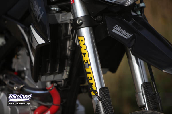

A giant rebuild of the suspension. The forks and rear shock were boxed up and sent to Race Tech HQ, where taking into account my weight (220 lbs + riding gear) and the intended purpose of the KLX (terrorizing the streets - and maybe hitting the track once or twice) Race Tech went to work on the originals.
What emerged was something beyond my greatest expectations. The performance of the suspension before vs after is night & day. The spongy, bottoming out front forks and gushy rear are now revamped and provide razor sharp response. It's like getting off an old, under-sprung scooter and hopping onto a sharp, new Ducati.
Clocking in at about $900, it's a pricey mod, but getting the stock suspension reworked is a heck of a lot cheaper than replacing the forks and rear shock altogether. The end result is easily a 100 fold improvement in performance.

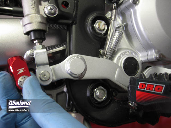

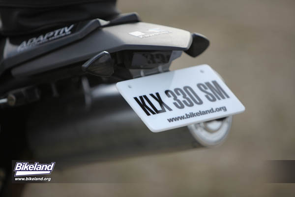

This is one cool shop. Wheeling have done their research and stocks parts to convert your stock bike into a Supermoto. When it came to our little KLX, Wheeling already had cross reference information for our bike vs its Japanese counterpart - the D-Tracker.

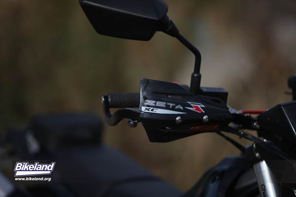

Wheeling stepped up with a bucket full of parts including an LED fender eliminator kit that let us bin the giant pizza box size stock fender, smoked LED turn signals, beefy footpegs, ultra-cool bash guards with LED turn signals in them, red shiny anodized bits to dress up the engine, a billet gas cap cover and the prerequisite red radiator hoses.
Their trick shorty lever set completed the package and made sure that our KLX would look as good as it would run!

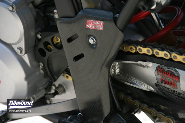

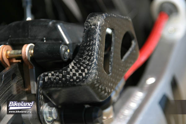

Light Speed Performance

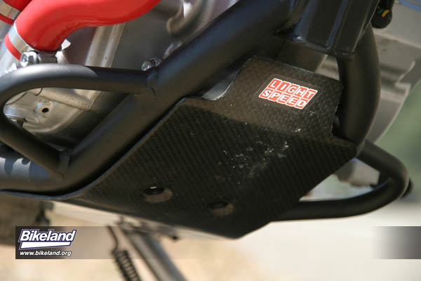

Mmmmm .... Luscious and tasty Carbon Fiber

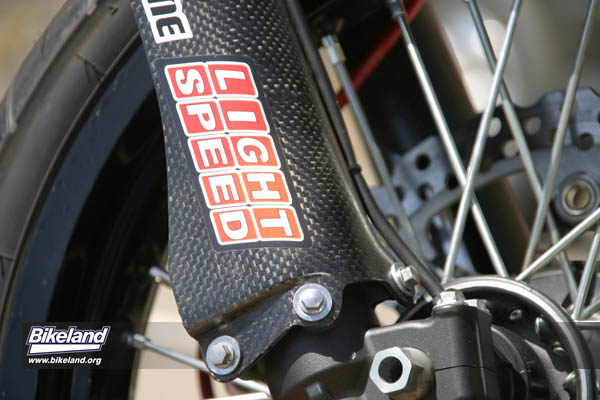

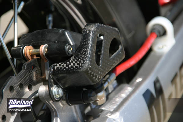

Carbon fiber bash guards, heel guards, fork guards, frame guards and caliper protectors. LSP makes the carbon you find on real Supercross bikes that are actually running in the Supercross series. Since their stuff is all over James Stewart's Yamaha 450, so it's definitely good enough for us.
Carbon fiber isn't just ultra-lightweight and pleasing to the eye, it's functional too!
www.lightspeedperf.com

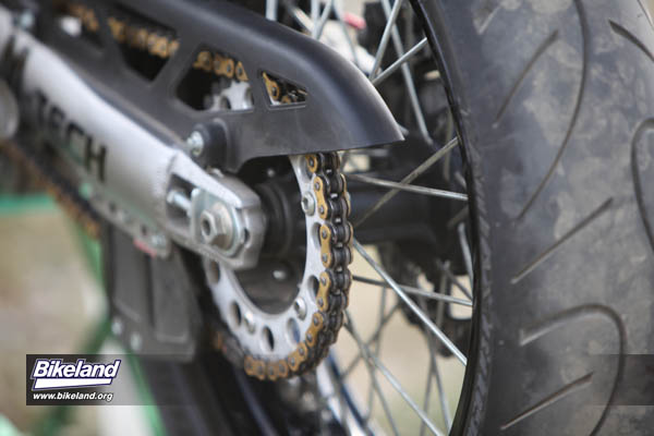

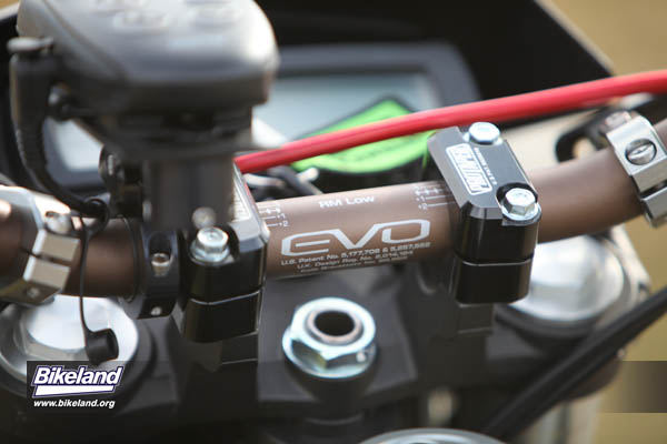

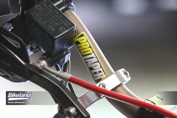

Handlebars & Chain...

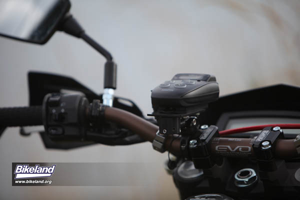

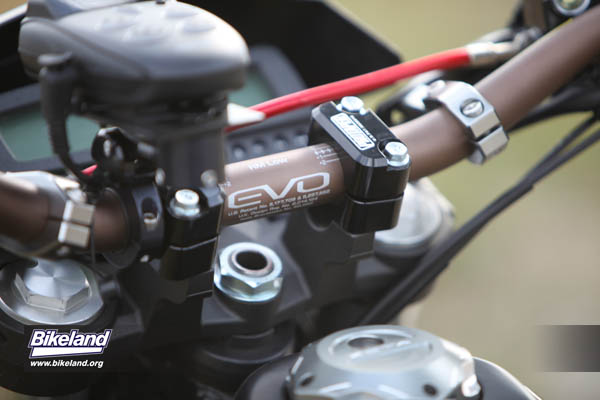

Ditching the rinky stock handlebars and chain isn't a must, but it sure does help. If you don't want to shell out big cash for a new top triple clamp, then you'll welcome Protaper's universal mounting adapter as the top clamp of the KLX has the OEM mount cast into it so you can't just toss the stock bars and replace them with a different set without the Protaper adapter.
The Protaper EVO Fatbars and Protaper grips help improve feel and handling - and they look like a million bucks.
A Protaper chain replaces the original and helps put the extra power to the ground now that the engine actually has some grunt.
www.protaper.com
Sprocket Specialists

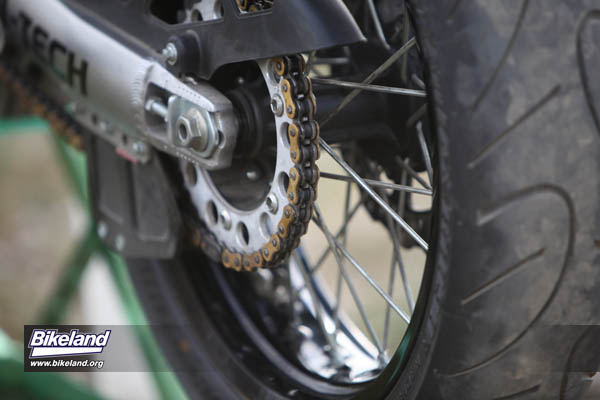

No one in the USA, or anywhere we called for that matter, had fitment for sprockets for this machine - it was simply too new. We sent the stock sprocket to Sprocket Specialists and they machined up some new versions allowing us to go up a few teeth and change our gearing.
If you want to order sprockets for this bike, now you can, and it's specifically because of this project that it's possible!

Again, the bike was too new for anyone to have fitment of lines, so Galfer made us a custom set. Braided lines in red to match those fancy red radiator hoses. Without the braided lines installed, when you grabbed a handful of brake you could see the hose flex as the lever mushed the bike to a stop. Galfer's lines put that issue to rest. Now the brakes are rock hard and you can stand the KLX on its nose.

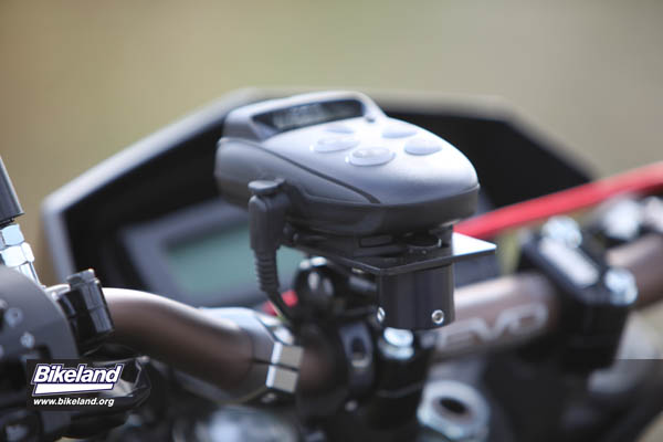

Based in Florida, Techmounts makes some of the coolest mounting kit for motorcycles you can buy. Model specific, they can fit almost anything you can throw at them, and the mount will look awesome and exceed your performance expectations.
We've stuck cameras, GPS, radar - you name it - to Techmounts products over the past decade without so much as a hiccup.
We needed to stick our Adaptiv Technolgies radar detector to our project bike, and we knew they'd have no problem getting us a mount to fit the Protaper Fatbars, and they didn't disappoint.

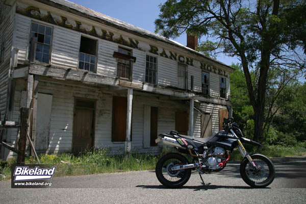

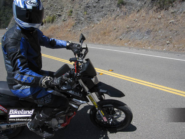

We jumped our horsepower from 18 to 29.8 - dropped piles of weight, and now we have a real Supermoto. Power wheelies? No problem. Stand it on its nose? Check. Suspension? Perfect. Looks? Good to start, mmmmarvelous now.
We covered every corner of the KLX, and so can you.
