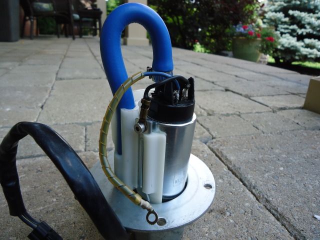

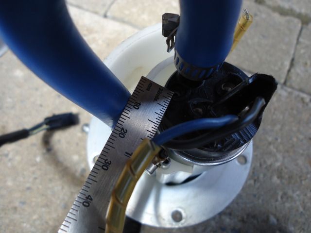

Guys just wondering if you can point me in the right direction as maybe this has happened to some one else.
My fuel presser has been all over the board so today started digging see pics below.
Can someone tell me where to buy this rubber Gromet or gasket # 74 for this pump ? Almost cost me a motor, fluke that I caught it. Cheers

2nd,,,,,, this going to happen again I would assume ?
It happened to me three times. They don't like fuel pressure over 70psi.

This happened to me twice on my bike . It caused me to have to jack up my fuel pressure and run a shit load more fuel to compensate for the escaping fuel . I bought mine from the dealer for $12 . The cause of the problem was due to me pushing the new fuel pump to far in the hole and not running a big enough plastic piece between the nipple of the pump and the rubber piece .

After reading posts above I'm sure this will happen again,,,,,so,,,,,, Made a attempt at a fix. Only to find out at the end just prior to install the frost plug under the regulator housing has popped.
Grrrrrr.
How can this be happening when I'm no where near Max pressure of the pump,,,,,, This F..k..g pump is getting the best of me.

this is why the serious race guys run bigger injectors and lines, and reduced fuel pressure... 1:1 boost referenced fuel regulators...
the only pumps cabable of maintaing a linear fuel flow per psi over 70 psi is the billet square block type that kinsler or wedco make.
They are $600 pumps, but flow does not drop as pressure increases
