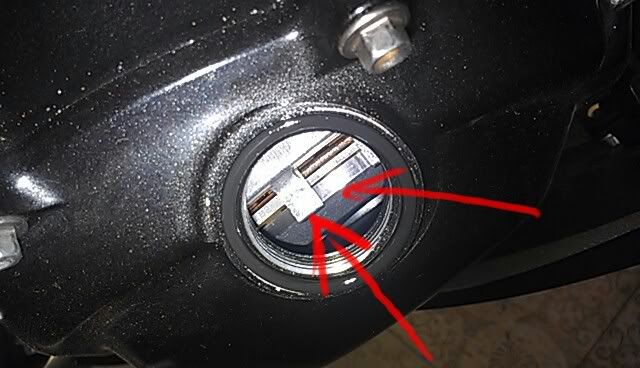

I guess no matter how much things change, clutch problem stay the same. on the older models You could take the oil cap off and look at the clutch if the installed heights were right, the outer edge of the clutch basket would be even with where the pressure plate dropped over. This was always a quick examination of how much clutch wear You had. not so much that the clutch was down , but that you were losing spring pressure because of it. And that made things worse. I haven't looked at wee bike to see if that's the same? a quick fix would be add shams to the Springs to make up the difference The clutch was down. obviously this would not fix warped steels.
Ken
Trying to picture what you are saying, here is a picture of my clutch with maybe 60 passes on it, is this what you are talking about

posted May 26, 2012 11:18 AM        Edited By: RICH CRAFT 1 on 26 May 2012 18:29
Ken
yes, that is exactly right. Those two arrow should line up even. looks like you're down about 30 thousandths. That's not bad. It just means you've lost that much spring pressure. As long as the clutch is still working good That's not a problem, but if the clutch feels like it's week. You can shim the Springs and you are good to go, unless the steels or bent. and that's easy to tell when the steels are in good shape, and you pull in on the clutch There is no drag, but when they are bent the bike wants to pull a little bit even with the clutch in. I can always tell when mine are bent when you go up to the line and bring it up on RPMs. The bike will try to pull even with the clutch in. When they or in good shape There is only a small amount you have to let out on the clutch for the bike to leave.

Bently
2012 14r In Blue and no Mods!
Posts: 5428
posted May 26, 2012 11:23 AM
Ken
i think its different, hopefully someone else looks but mine has been inside what i call the fingers since new. on the old models it started even.
Bently is right , you can't check the clutch like you did on the gen 1 ... Brand new mine were way inside the fingers of the clutch basket ..
thanks lee that's what i was hoping!
Ken
why can't you notice where it is after the install and watch it from there?
wee
codyc_13
Posts: 340
posted May 26, 2012 12:07 PM        Edited By: codyc_13 on 26 May 2012 19:10
Thanks, that will save me some time not having to pull out the clutch and measure it.
