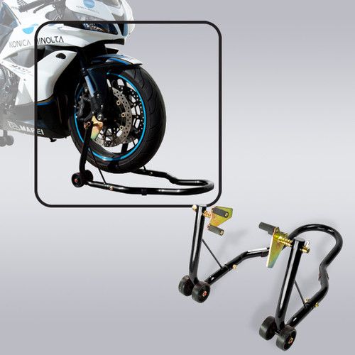

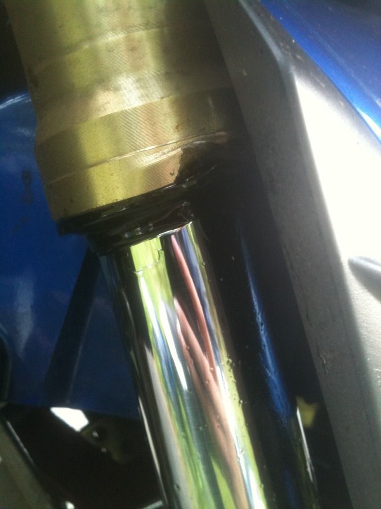

Saw smoke as I stopped to check my phone. I get off and see oil all over my calipers and rims. I then realize my fork is busted. My tire also had white patches all over it. I ordered a used fork, pirelli diablo, and a jack stand. My question is, will this jackstand be good enough to remove the fork? I think I ordered the wrong one. (First time changing a fork). Here is the picture of the stand I bought on ebay and under are various pictures of the fork/bought items. Thank you.

wtf happened? looks like more than a fork seal leak.

Ouch. That stand will have your forks resting on the stand.
Steering Stem front stand
http://www.cyclegear.com/eng/brands/pit-bull

IF you get a pin type stand...you won't need any jack or anything under there.Pitbull makes a pin stand..but there's lots of em out there.You need to get that frontend free of any stands or stand forks.Anything attaching to the axle,forks...any of that...it won't work.

Whatever it was that either hit you,or something seriously slipped and bent that outer tube...I hope YOU'RE okay...you didn't get hurt did ya?Whatever it was...there was LOTS of force right there to do that.

It's very obvious that your fork is bent in the picture. What did you hit?
