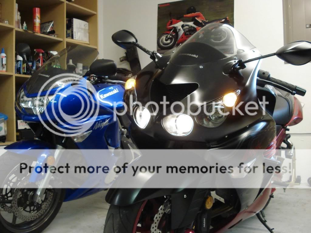

I replaced those light with Yellow lights. They look okay, I'll add a pic later. I have the package at home so I'll also post the info on the light. Did someone mention green? I would love a different color, albiet legal color. The yellow looks better than the white, but purple would look cool on my '08 SE

Here's a pic of the bike with the Yellow lights. Also a pic of the packages...
