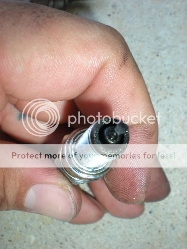

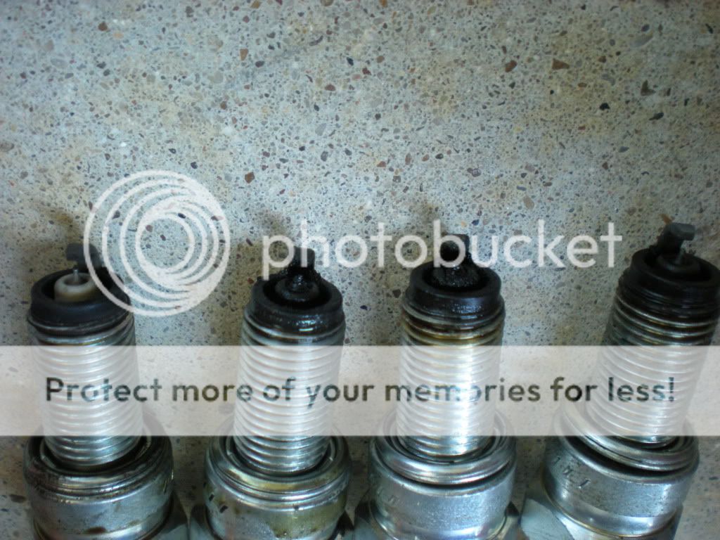

Meangreen14
Posts: 316
posted May 19, 2012 02:24 PM
i havent had time to do anything but pull the plugs hear are plugs

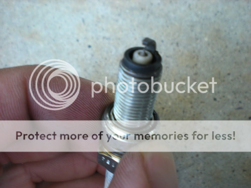

Meangreen14
Posts: 316
posted May 19, 2012 02:30 PM
clean one is plug #1 plug 2 & 3 are oily and have plaque like build up on them .......

Meangreen14
Posts: 316
posted May 19, 2012 02:32 PM
oh and there is oil on the nut part of the plug where socket goes after threads???

SteddyTeddy
Posts: 1659
posted May 19, 2012 06:18 PM
You've got problems. Take the head off and have a look.
Oz Booster
Posts: 197
posted May 19, 2012 06:22 PM
external oil is probably from the cam cover gasket
What is done in the pair valve area ??,
pretty much looks like you have to strip the motor for a piston or 2 but i'm curious if a reed or gasket problem under the cam cover could be allowing exhaust gasses into the cases and or pulling oil from the cam area
