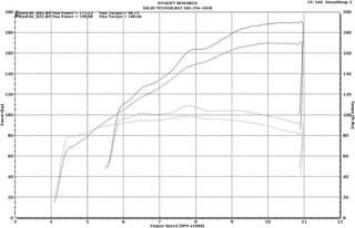

Milled head and 47mmTBs
Almost a 20hp gain. Not to sure on how much was takin off the head but I'll find out. So almost a 20hp gain for about 1000 bucks if you do the work your self

171hp 98tq stock. 190hp 108tq after head work and TBs

Boy, I sure must have done something wrong then. According to my tuner anyhow, I picked up 3-4 horsepower over stock with a fully ported head from Adams milled .018" and had the head gasket mod done as well. This was also with 47mm throttle bodies. I guess maybe my actual head porting cost me 16+ horsepower vs the stock ports. In all honestly I will say that we lost a MPH in the 1/8th vs not having the headwork done but I blamed it on weather conditions. I should have left the head alone and just milled it apparently. We eventually got it running pretty decent but it took a lot of seat time to pull the numbers out of the combo.

I have seen on many dyno pulls over the years that dyno numbers can be different when starting at 3-4k as opposed to 5.5k as you see in his graph. Or he could have been running it in 5th or even 6th gear to explain the 5.5k start. Something to think about as far as what actual gains were received.

Damn mine only picked up 18hp from a port job ,milled and 47's. But i picked up about 4-5mph in the 1/8th.

porting the heads on the 14 dont do any thing much , the super sport head works mint they cut it 60/40 hand blend the ports and degree the cams. 110-108 or 108-108 , no hand blend or 47mm i was 189.9 on a 90'degree day. now i have hand blend and 47mm but still need to put togther. compition cnc know there stuff.
