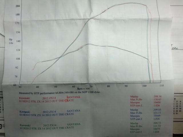

So took the bike back up to HTP, where i had my baseline number pulled when the bike was brand spanking new(1 mile on odometer). This is what i have on the bike so far: PCV, Guhl Flashed ECU, Flies out, Brocks CT single and <0 synthetic oil, 8+ stretch with 530ZZZ chain, +1 on rear. Bike has just over 2k miles on it
These were the base numbers with the bike straight from the dealership, completely stock 1 mile on the bike.
Max 209hp/131tq@10475RPM with STP correction factor of 1.026 stock rear air pressure
41 degree day and about 28% humidity

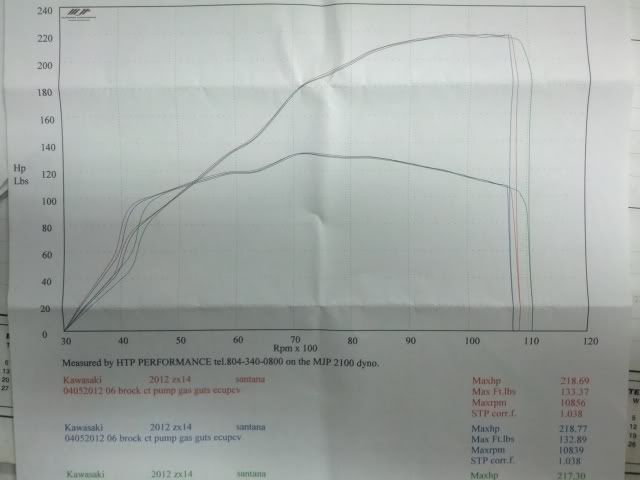

Today i went there with the mods listed above and the loaded brocks street map:
The ambient temp was 62 degrees with 43%
With the Brocks Map i had a baseline pull of 211hp, dont remember the torque
Cecil went ahead and tweeked it and was able to squeeze couple more hourses out of it.
Final numbers with Cecils Tweeks was:
Max 218hp/132tq@10839RPM with STP correction factor of 1.038 with rear air pressure at 35psi
Now going into today i was expecting some better numbers than the 211hp baseline but i was told to consider the following:
1) The baseline numbers with the stock bike the temps were 20 degrees colder and alot less humidity, it was already raining outside and he keeps the doors to the warehouse open.
2) The bike is stretched about 8+ along with the the chain was switched out for a 530ZZZ and tightened up a bit, im not sure how much of a loss that would be on a dyno.
3) On his dyno which has an actual "weather station" from what he was telling me, that .012 difference in the correction factor is about 8HP loss.

here is the chart with the bike completely stock
Here is today chart after all was said and done.

I've heard of SAE and STD, but what is STP? Is that a greater correction factor than STD?

Damn look at that TQ jump from stock to modded .. HP Jumps up better also and holds on much longer .. Big peak HP numbers are always pretty to look at but the numbers below peak tell the real story ... ...That is one strong bike ..

Also, is the re-flashed ecu rpm only 10,856?

i see what you mean by it holding on for a longer duration versus a peak.
ECU was raised 500 over.

it looks like max rpm difference is 256 from stock to reflashed.

it looks like max rpm difference is 256 from stock to reflashed. 10,856?

That's not what you should be looking at ... peak hp stock was right at 9500 ( look at the first chart ) ... Peak HP after mods was around 10850 .. If you look you will see the first chart HP dropping like a rock where the second chart is holding and not dropping .. I wish we could see the charts over lapped ..Then you would see the big picture ..

yes the after chart does peek higher, I would like to see the before and after a/f
