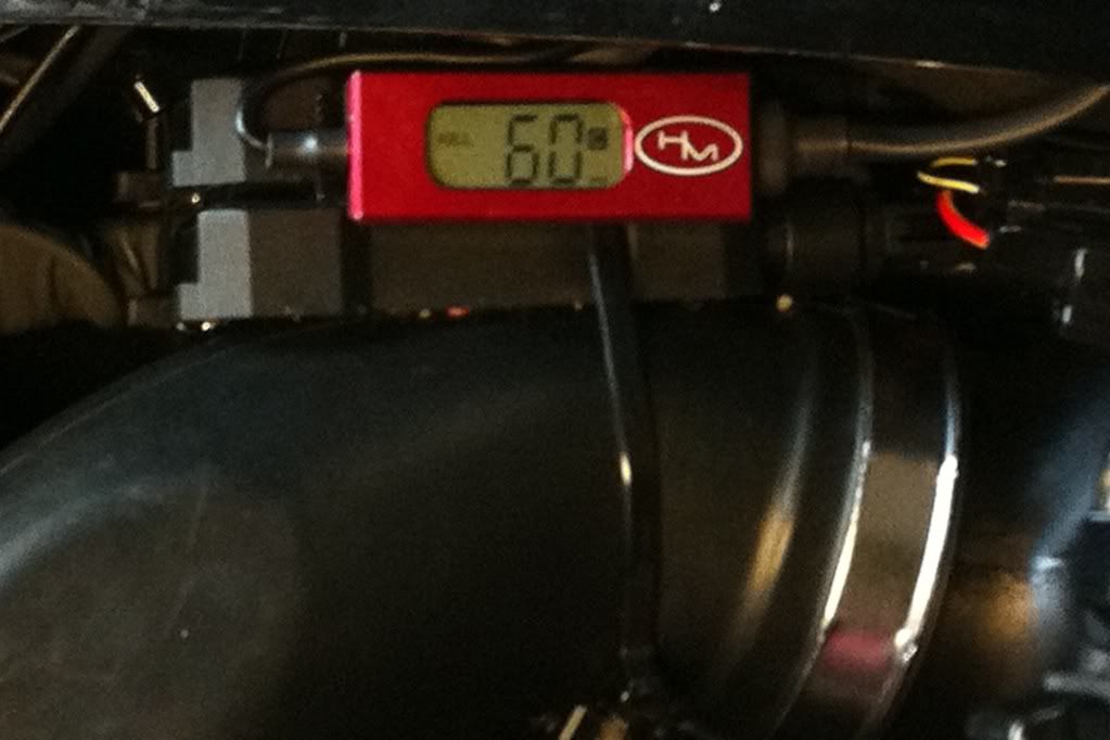

A few people have asked me about the HM Quickshifter I have been using and figured I would write a brief product review. I have been messing around with the HM Quickshifter Plus (comes with loom to fit Yamaha & Kawasaki coils) for about 2-3 weeks now. I have ridden about 250 miles using this product and have to say it's the best Quickshifter for the street I have ever used. Many people told me to go for the Dynojet Quickshifter but after 3 of them failed on me, a few said get an air shifter. I started to research several products... Quickshifters (Dynojet, Bazzaz, Translogic), Air Shifters (MPS, Cycle Tek, Muzzy's), Electric Shifters (Pingel, Holeshot). I have never heard of HM Quickshifter until a mechanic at the shop I go to told me about the HM (He was a Pro racer and excellent mechanic so his suggestion was taken seriously). After looking into the Quickshifters HM had the best reviews, Google "HM Quickshifter Reviews you get THOUSANDS of hits.... This is the same setup that many professional racers, teams & Isle of Mann riders use. Keep in mind I am a street rider, not a drag racer like Wheelie, Smokin, etc... if I was drag racing my choice would have been an air shifter all the way.
Installation: Very straight forward for the 2012 ZX14R.
1)Take plastics off left side
2) Hook up loom to the top of the coils (unit gets power from loom)
3) Wire up control unit (Just 1 plug from the coil loom + 1 Ground wire)
4 Velcro Control unit to upper inner fairing
5 replace plastics
Setup: Takes about 30 seconds.
1) Turn on bike while holding down button on back of the control unit, when it counts down from 5,4,3,2,1,0 Release button on 0
2) Setup Strain gauge to read Compression, Extension or Both (Compression for ZX14)
3) Set unit sensitivity (70 is my magic number for the ZX14 with Vortex Rearsets)
4) Set kill time 40-150ms (63 is the magic number for the ZX14)
Done!!
Positives: A few things that I like about this unit are-> No moving parts (all digital), Does not rely on movement of the gear lever- pressure (strain gauge technology), ultra smooth, no mechanical setup, no wire splicing needed, fully customizable setup, control unit is very small, and a LIFETIME WARRANTY.
Negatives: Bike will not run if control unit is not hooked up. You get what you pay for, a quality item with a lifetime warranty is not cheap...
Control module tucked away in left inner fairing by ram air duct
Shifter mounted on Vortex rear sets using Dynojet M6 to M6 rod
Video shows HM Shifter in use WOT at about 15 - 30 seconds into video (the rest most of you would probably find boring)

Is the black box you have zip tied to the ram air tube a part of the HR control unit or is that something Stock??
Seno
BANNED FOR LIFE!
Posts: 1230
posted January 07, 2012 09:06 PM        Edited By: Seno on 8 Jan 2012 05:06
HID low & hi beam digital balasts
